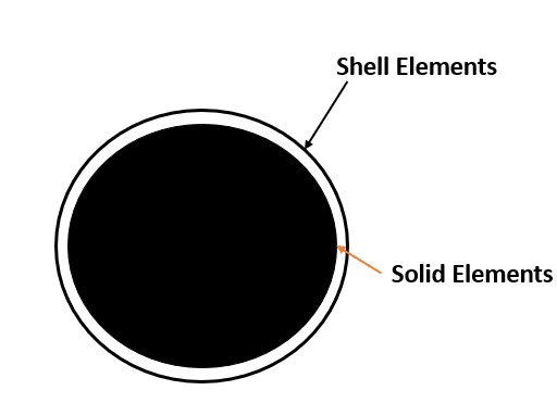

Hello,
I need some help in trouble shooting/modeling this setup. I am using MSC Nastran as solver.
The setup is shown below with the cross-section shows the arrangement of the beam.
The outer skin is made from Carbon Fiber laminate and the core is made of foam.
I have modeled the the beam as a combination of PCOMP (CQUAD)-PSOLID (CHEXA)-PCOMP (CQUAD). The PCOMP is setup as orthotropic material (MAT8) with plies and PSOLID is configured as an isotropic material (MAT1).
We have test data (only deflections) for the beam. But when we run our FE, the deflections are coming quite high compared to test (around 35% higher). Trying to figure our where I am going wrong. One more note, there are not DOF coupling elements between PCOMP & PSOLID. No RBE2s or any kind of contact. We have tried with glue contact and we are finding that it making the model more stiffer. I am not sure if we need any kind of DOF coupling element but the deformation looks OK (transverse bending).
The shell elements were extracted from Hexa elements faces, so there is no issue of node connectivity or equivalencing.
Before figuring out the material properties, we want to make sure our modeling methodology is correct. I would appreciate any pointers from experienced people on how to proceed.

The objective is to establish methodology of FE modelling using a simple circular sandwich construction beam (for which we have test data) before moving to more complex cross-section (airfoils).
The material properties are defined as follows:
1. For Composite: Fiber properties defined on a MAT8 card.
2. For Foam: Isotropic Properties defined on MAT1 Card
The PSHELL elements were extracted from PSOLID faces...thus there is node-node connectivity. I want to figure out why our FE model is softer compared to test data. The test data does not include any strain values only tip deflection values.
Basically, I am thinking that post-curing, there is quite a bit of resin uptake in the foam core which is making the foam more stiffer than what the values on the manufacturer's sheet gives. Of course, the manufacturer's data sheets gives values of mechanical properties carried out on actual foam (not resin soaked).
Is there any empirical way of calculating or scaling mechanical properties based on foam & resin type? Of course, one can always adjust by scaling up or down the material properties of foam to match test values but perhaps, then it has to be done each time we have a different construction or shape!

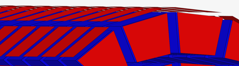

One thing I did not specify explicitly was that there is no gap in the elements between PSHELL & PSOLID. What I have shown in the cross-section images are exploded view for clarity. In the actual model, the PSHELL elements just lie (NO OFFSET) on top of PSOLID elements/faces & thus ensuring node-node connectivity.
In the image below, the blue elements are PSOLID & Red ones are PSHELL. The elements have been shrunk visually for clarity purposes but PSHELL are lying on top of PSOLID.

by "node tp node connectivity" between the shells and the foam, you mean that they have common nodes, right ? the shell nodes are the foam nodes, yes?
is the foam bonded to the shells ? (I'd think so) is this a rigid or flexible bond ? is there something you could see under test too check this ?
if elastic, then you'd need two sets of nodes with a CBUSH between them ... or something like.
RB1957,
Yes, the shells & foam (solid elements) share common nodes.
If you are asking, are we using bonded contacts between shells & foam (solid elements), the answer is NO. Since most of the load transfer between shell & solid elements happen axially, we thought DOF compatibility will be maintained. Further, in our FE model, if we look at the deflections, they are matching the expected shapes i.e. typical beam deflection and we are not getting any rigid body errors.

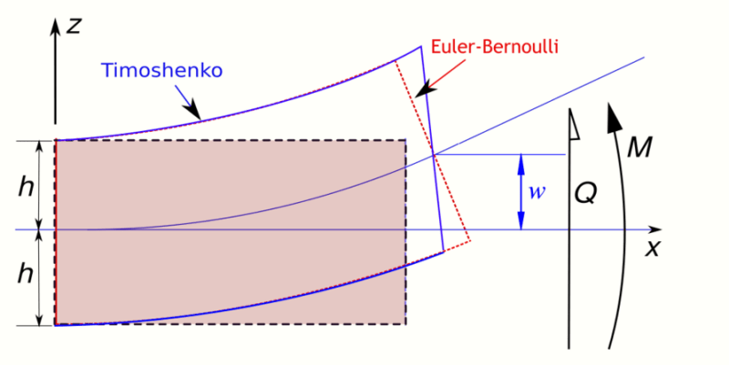

What happens if you model the beam as an equivalent section (equivalent EI, GA by summing up contributions of slices along the vertical axis in the cross-section) and compute the displacement with elementary shear-deformable beam theory (tip load should be simple)? Results still off?
If the dimensions are as shown in your sketch (height-to-length ratio of five or so) and the displacement is more than 10-20% of the section depth, there might be geometric stiffening occurring during in the test (as already mentioned in this thread) which a linear analysis does not capture.
