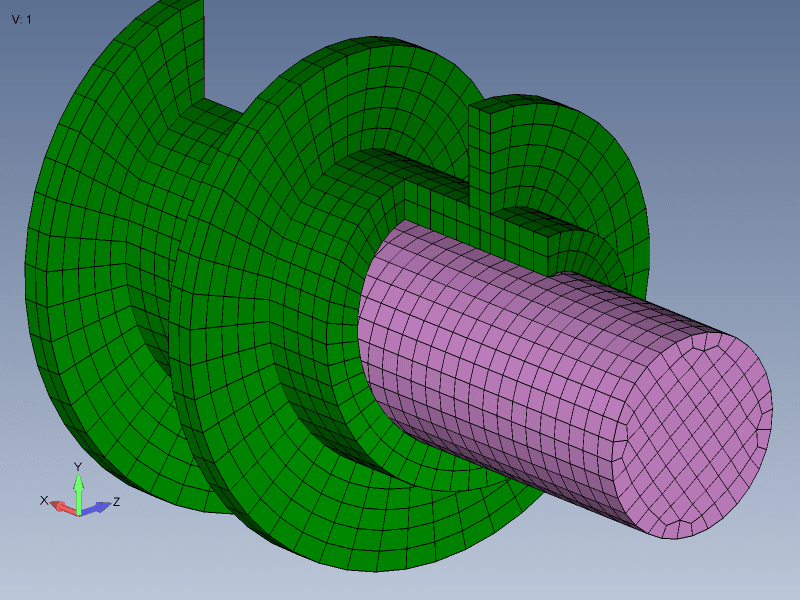

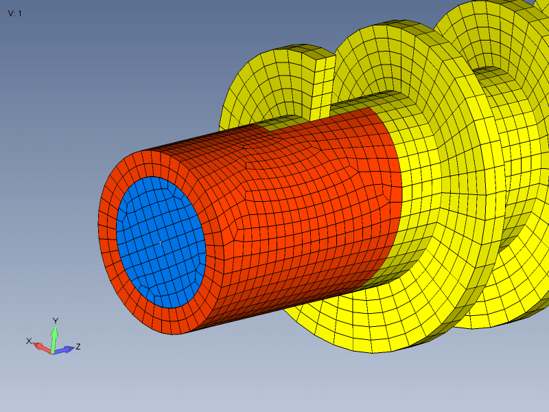

Your problem interested me. I made a complete grid. Here red and yellow mesh has common nodes - it is conformal mesh. This outer mesh should be glued to the blue core mesh. You can make central part even more tiny to move glue interface further away from region of interest. I made this mesh in Femap and made CAD geometry in Solidworks. If you use NX than you should figure how to do it by your own. this may require some CAD operations prior to meshing. I can upload mesh and CAD geometry if needed.

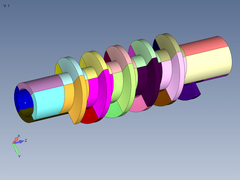

As for your problem, here is one solution that comes to my mind. Revolve geometry into small part of helix. Let`s say 90 degree portion. Than copy this part with rotation to make complete helix. Now you have many small parts that can be hex meshed as 3D body. Here on picture I make each 3D part with different color so you get what I mean.
It is possible that it will be easier to recreate model 3D geometry in some CAD software from scratch than modifying existing shaft geometry.
