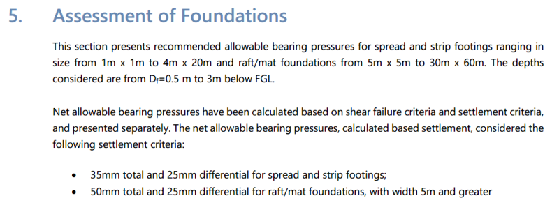

Regarding point 1 - you should use the term "bearing capacity" when talking about shear failure i.e. when the foundation fails dramatically and plunges (to some degree)into the ground. This is the Terzaghi calc you are asking about.
The allowable bearing pressure, in my opinion, is the bearing pressure which results in settlement less than your criteria, often 25mm. This is calculated using consolidation theory (developed by Terzaghi also, but different to my first point, elastic theory, and emperical solutions (i.e. schmertmann, christian and carrier, burland and burbridg).
The below is how i typically present it.
