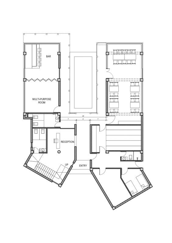

Requirement of expansion joint in irregular Shape building
Yug Maharjan
Sep 19, 2023
7
NP
As described by codes is it necessary to place expansion joint in "H" Shape Building?
depends on the size of the building
Well it should not be necessary but could be preffered to place expansion join, Incase you performe proper analysis to assess the dynamics of the structure by performing the required type of analysis as specified by your code.

At points where stresses are concentrated often crack, such as at internal corners of cutouts. It can be useful to give them proper direction, rather than let them decide to break up on their own in any direction they chose.
I know the complexity a structure can be prone to, but you don't always have the choice to break the structure into separate components either atchitectural requirements or geometeric requirements.

Can You share Some pictures or sketch of your problem for better understanding.

How Many stories does the building have?

Building length x-direction = 17.5m, Y-direction = 22.4m
Height of building 2 story = 6m
If you are asking about expan joints in the foundation slab and floor slabs, we need to see those plan views.

Two Stories with expansion joint would make it more vulnerable than stabilizing and have economic effect.

I think you would make more sense as essentially a design of two buildings. There seems to be a large central patio, or swimming pool or something in the middle. You can then connect them across the entrance hallway with expansion joint(s) there.
Dimensions and a few labels would help.
I looks like it is only one floor, but I see a atairway going nowhere. Is it 2 floor, or is one half higher than the other? Multi-level?
Seems like you should post some elevation views.

When i was doing buildings we worked on 20m intervals for expansion joints, at 22m i would say it is not necessary but it also depends on your foundation conditions and loadings, ie will it settle uniformly, is only part of the building double storey = uneven loading etc
