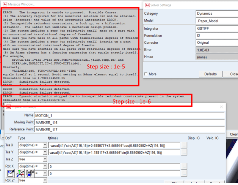

Hello, I have a problem in describe a motion in this body, i want rectangular body have a vibration in direction that I draw. I try to create this with using general motion or planar joint, part can translate in X,Y and rotate in Z, but also must always have this vibration in y direction of body. in general motion we have two markers. reference is in ground and the other is in center of body. I try to write this in motion :
x = displacement : A*sin(w*time)*sin(AZ(part_marker,ground_marker))+ DX(part_marker,ground_marker,ground_marker)
y = displacement : A*sin(w*time)*cos(AZ(part_marker,ground_marker))+ DY(part_marker,ground_marker,ground_marker)
the body can rotate in Z axes and for vibration Vector perpendicular to body I decomposition with AZ() function (Z angle).
I used DX and DY for free translation motion in these directions, but i got this error in simulation :
A probable cause is an over-specification of initial velocities of bodies.
Please specify fewer initial velocities and try again
ERROR: Simulation failure detected.
I try to simulate this Model :

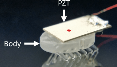

PZT(Piezoelectric) is actuator of this robot. I try to create Vibration in direction that draw in previous image with general motion. robot can translate in X and Y direction(Global) (Y direction is free for any jumping and etc.) and can rotate about Z axes (model in XY plane). Vibration always is in normal of the body (normal to PZT plane). so how can i create this vibration? as I said for free translation I try to insert DX and DY in function, but simulation failed.
After create robot and insert this motion correctly, how can find resonance of legs? legs is connect with revolute joint and have torsion spring.

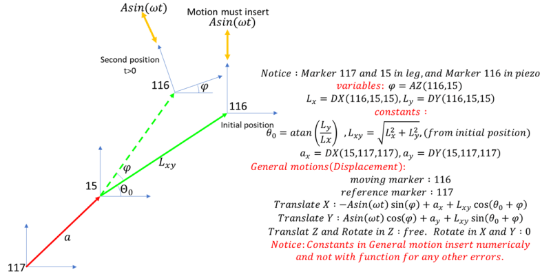

for better describe of my problem:

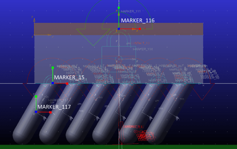

define markers:
define motion from markers:
simulate and errors in two step size (1e-5(or bigger) and 1e-6), varval(41) is A*sin(wt):
I cant find any redundant constraint in model.

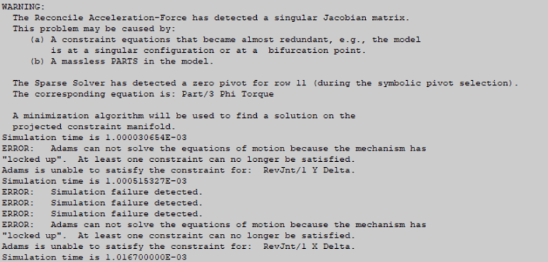

Also when in motion insert X direction motion free I get this error in 2 other simulates:
Base ( piezo(orange part) and base are fixed that could see in first image). Base and leg have a revolute joint and torsion spring. legs have a contact force with plane (plane fixed with ground). in previous I write function for motion with reference to ground that have this error:
Please specify fewer initial velocities and try again.
You can't get modes with Contact. So the legs are sprung against the marker 114 block, and are restrained by the ground.
This is massively redundant and very hard for the solver to deal with. What I would suggest you do is add damping to the torsion springs, and build the model with the legs clear of the base. So the first thing the model will do is drop the legs into some sort of equilibrium. You may need to stuff around with the contact statement to get an intital solution.
