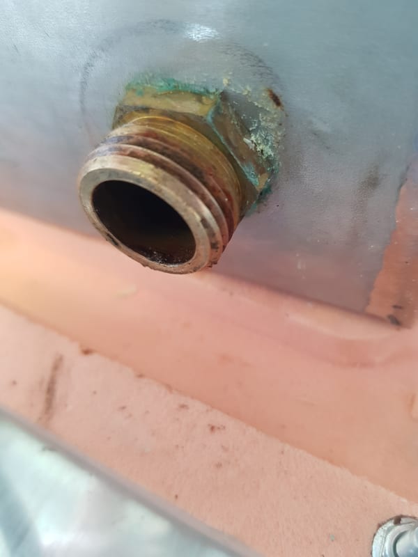

In the past we have had brass valves on a copper brazed steel 304 heat exchanger and it resulted in the copper in the heat exchanger being corroded.
This image is of a brass threaded nipple screwed into a 304 steel small water tank.
The corrosion is visible.
We have taken the approach to always ensure dissimilar metals do not touch each other, but it is not always convenient.

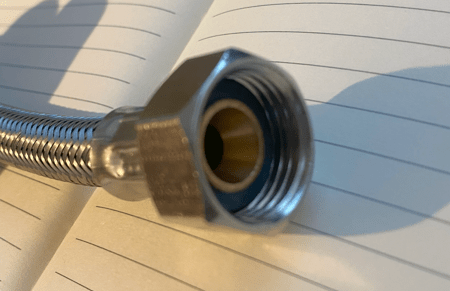

I would like to be able to attach flexible hoses directly to a steel 304 treaded connection connected to a small water tank (max 45 C), but the tend to have nickel plated brass connectors with a copper insert

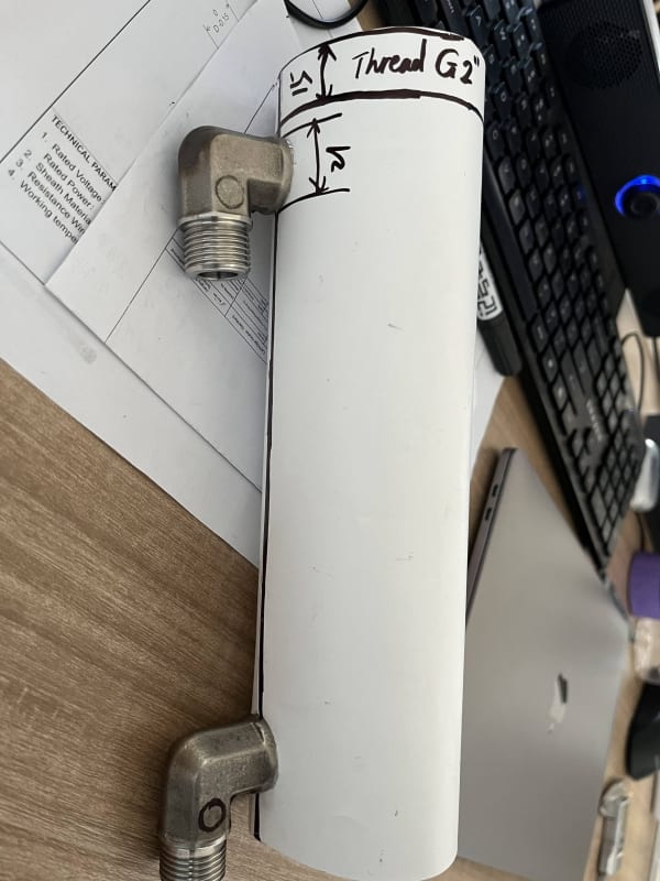

This is a mock up of the water tank

The brass valves did not cause your heat exchanger to fail. Copper brazed SS heat exchangers are for oil and non-corrosive fluids. You had dissimilar metal corrosion between the stainless steel and copper brazing alloy. If anything, the brass valve delayed the failure some.
Stainless steel adapters from G thread to 37° JIC flare are readily available as are hoses.
