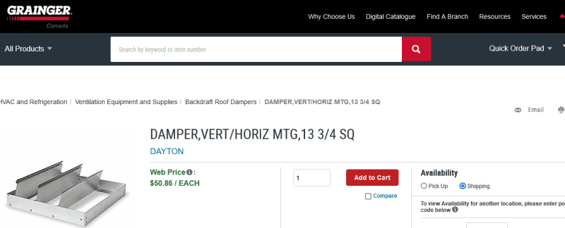

Something like this:
Back Draft Damper
The price is in Canadian Dollars, expect to pay less.
These should be on all fans.
The #1 fan will need one if it trips off for any reason.

Update- our site HVAC engineer lost the battle and the only thing that the project team agreed to do was to remove the magnetic trip from the breaker because it was "redundant" to the external magnetic trip mechanism (there were two for some reason after they made this change). I doubt this will reduce our nuisance trips but given that summer is over it'll be 9 months before we can test their "fix". Don't know what to say except this is one of the downsides to having design engineers as a corporate function and the knowledgeable site engineers too busy to be able to provide constant input to projects.
