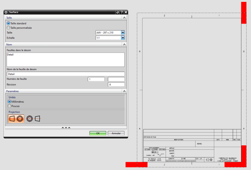

To make part drawings we use sheets.

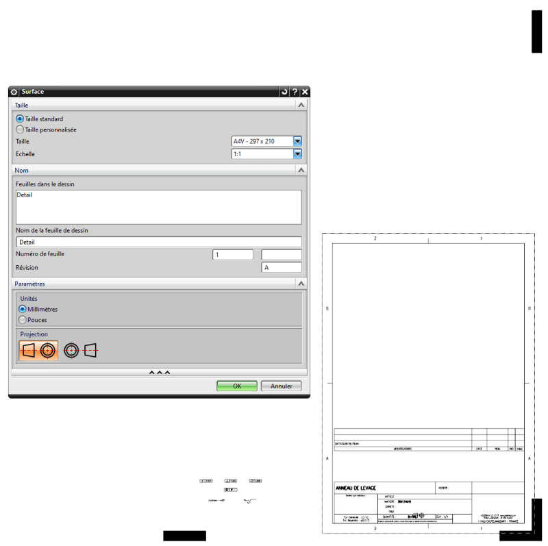

We have a problem which is that on old parts created in NX1888 when we want to make a drawing and integrate a sheet created in NX2206 the sheet is no longer good
sheet in 2206 :
sheet on the parts created under nx1888 :
why is the sheet not recovered as it was created?

Good morning,
I checked both and it is the same on both models.
Can you post a screen shot showing your sheet sizes ?

I wonder if the justification of the symbols changed for you. Was that symbol, or were those individual entities?
Good morning,
Among the elements that do not follow are: Custom symbol, Annotations, Table.
