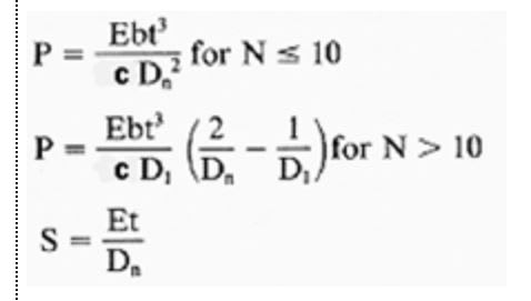

MintJulep - it's not a constant spring, but good idea. However, the equation referenced there is the same equation I was using.

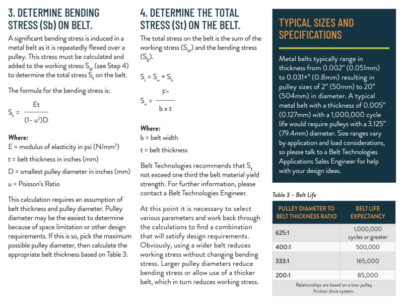

dvd - These are excellent resources, thank you!
Interestingly, their equations use Poisson's ratio. When I crunch the numbers, I get a higher value of stress than using my first equation. They also list a helpful belt life expectancy based on pulley diameter to belt thickness, which for my scenario puts me around 800,000 cycles. They don't explain how they arrive at these numbers however.
I also notice that all of the materials they use in that guide have high tempers (full hard), giving large values for yield strength, which likely explains the high numbers for life expectancy.
So, I think I can conclude that my calculations are correct and the stresses from simply wrapping the strap around the drum are fairly high. However, this does not solve the question as to why I am greatly exceeding my estimated life. I think I need to take a harder look at my fatigue calcs.
