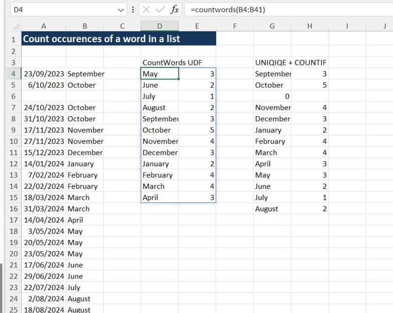

This is a response to the original question.
There are many ways to do this, but creating a User Defined Function (UDF) using a scripting dictionary is fairly straightforward, and once set up is very easy to use.

Use the function in a worksheet, just like a built-in function:
I have also added use of the built-in UNIQUE and COUNTIF functions that give the same results (if you have them available), except they also count empty cells.
I have attached the sample workbook shown in the screenshot above.

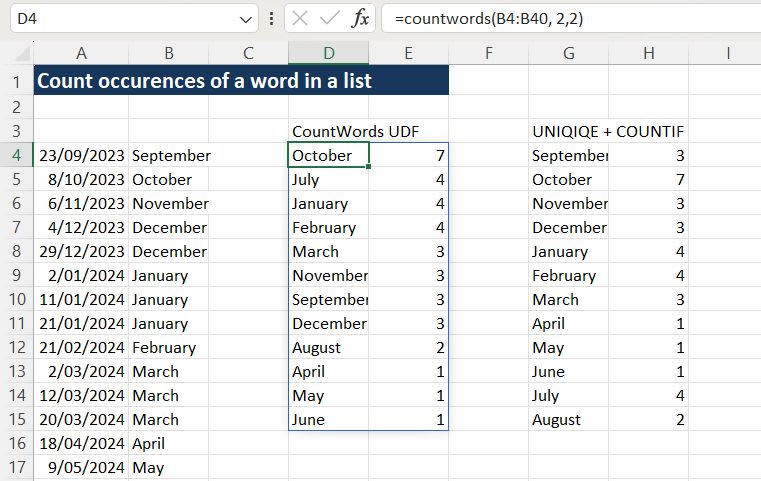

Just on the Excel side (I know nothing about CATIA), I have added a sort option to my CountWords function, so it will sort on the words or count columns, in ascending or descending order, or by default return unsorted.
Updated file with open source code attached.
