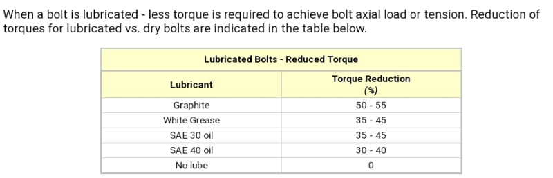

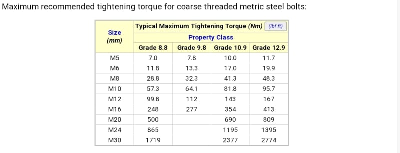

optimum tightening torque required for bolt under static and dynamic conditions
Bolt size: M30,
Material: AISI4340 alloy steel
Grade (property class): 12.9
All Bolt threads to be lubricated with MoS2 grease during torque tightening.
Temperature variations will not be there.
Bolts are not subjected to any external loads.
If these bolts are used as foundation bolts of gear casing (static condition), What is the optimum tightening torque required?
suppose, if these bolts are used in flange coupling to connect the gear shaft with shaft of generator (dynamic condition). What is the optimum tightening torque required?

Wasn't aware that there are different torque recomendations based on static vs dynamic condition
There isn't
If you don't know what loads you need from your fasteners, you should be using the standard values. Unless you have a substrate issue, but that's more complicated.
