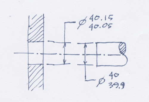

In cases of limits and fits for features of size modeling to mean will prevent you from specifying the nominal dimension with the asymmetric tolerance, from technical reasons, unless you do a workaround like a fake dimension. Then you will change the dimension structure & loose the design intent communication.

Nominal and mean kick in when you call up limits and fits on your CAD drawing thus...
If I had used CAD and I had sent my CAD models to the shop, they would need to know how I modelled my features. Are the shaft and hole both modelled to [⌀]40mm? Perhaps the shaft has been modelled to [⌀]39.95. Perhaps both pieces are modelled at MMC! These distinctions are meaningless if the thing is hand drawn, or modelled but not dimensioned.

6.1 GENERAL
Models represent ideal geometric constructs; that is, perfect dimensionality and shape aspect of the part geometry are assumed. Parts shall be modeled at a specified
dimensional condition(s); for example, minimum, maximum, or mean. The dimensional condition(s) shall be specified in one or more notes or in a referenced document.
9.2.3 Size Dimensions
A displayed feature of size dimension shall always
include a tolerance.
(a) Size Dimension and Annotated Model Agreement. A size dimension shall agree with the queried model value for the same feature when the model value is rounded to the same number of decimal places. This agreement shall meet one of the following requirements, depending on the tolerance expression used.
(1) Bilateral or Unilateral Tolerance. The displayed size dimension shall equal the resolved model value.
(2) Limit Dimensions. The resolved model value shall equal one of the limit dimensions, or a value within the displayed range of limits.
(3) Dimensions With Plus/Plus or Minus/Minus Tolerances. The resolved model value shall not be within the displayed range of limits.
