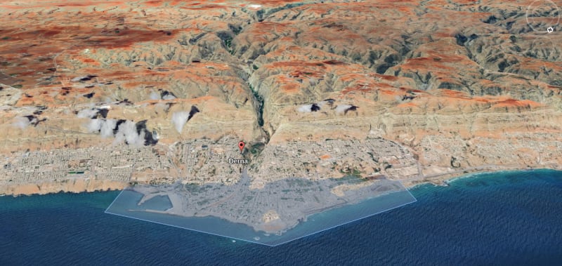

Dams without effective spillways is not acceptable practice.
RE: Dam Failures in Derna, Libya
Do we know that the dam spilled over or did the foundation fail?
Spsalso, what country? Alt. orollo, or... a barranco (revine). Arroyo is the stream in my usage, although depends what country and dilect. Spanish is not widely consistent across regions and can be very different between countries.

"Wadi" is a term used in Arabic countries, which just means a river or stream which is dry most of the time. Can have steep sides, but not necessarily.
That vertical structure is not a "shaft spillway". It is an inlet or control tower. It would allow some water to escape, but miniscule in relation to a properly designed emergency spillway.

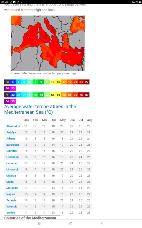

Current Med temp measured at 27.5°C 83F off Libya. Med is at all time max recorded temps. That same ole +1.5°C keeps popping up everywhere, even in my latest highest monthly average max kitchen temperature. 5yrs ago it never passed 25-26.
Not restricted to Med.

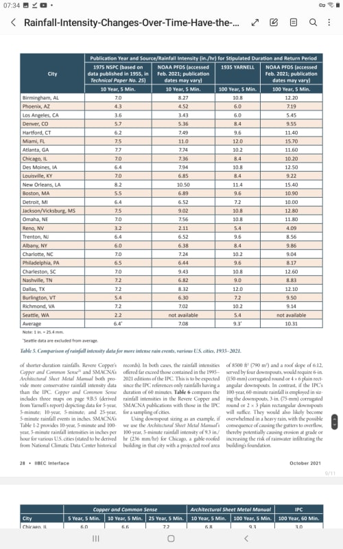

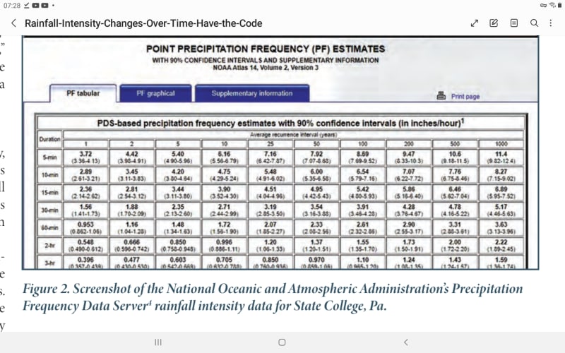

NOAA latest precip amount intensities and return periods are here,
https://hdsc.nws.noaa.gov/pfds/
check them against your old local building codes, they may be 34% or more higher for storm prone areas. Check Charleston SC 10 yr. Now Miami at +46%
Offshore Gulf of Mex platform design criteria was revised back in in 2010 to consider frequent CAT 5 storms.

1503-44, how is any of that pertinent to the Wadi Derna flooding due to Storm Daniel? 100 mm in 3 days may be extreme in that part of the world, but any dam should have considered rainfall of that magnitude, if not much greater. The design, if there was one, was totally inadequate, and the worst part was the lack of emergency spillways. There likely would have been significant flooding over the spillways, but not as catastrophic as what occurred. The stated purpose of the dams was flood control for the city, and they spectacularly failed their mission.

The ASCE 7 hazard tool presents rain fall rates based on the Precipitation Frequency Data Server linked to above, and the newer editions point to those for structural engineers to design roof structures that have the potential for retaining water. Unfortunately, plumbing codes seem to be lagging behind and are creating a mismatch in expectations. I haven't had it happen yet, but I've come close to "code compliant" plumbing designs resulting in excessive retention on the roof now that I'm designing for more stringent requirements.

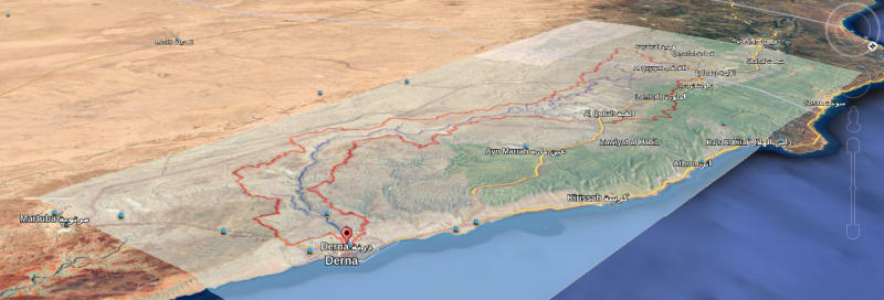

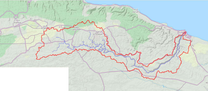

That little wadi drains 575km2
Putting houses in the downstream path was ... a disaster all by itself.

The numbers: Estimation of the surface runoff depth of Wadi Derna Basin (sebhau.edu.ly)
Quote (Abstract)
... As a result of the model applied, the annual runoff volume for forty years during 1960–2000 in the study area was estimated by 138.51 Mm3. Furthermore, a volume flood has been estimated, based on the flood of October 1945 and late November 1986. Those events called for average precipitation of 145 and 64.14mm respectively. The rainfall of 1945 produced a volume flood of 53.36 Mm3, which represents 40 % of annual runoff volume, while the flood of November 1986 was 14.8 Mm3, which is in good agreement with the recorded flood in the basin.
100 mm over 575 km2 (Wikipedia, Wadi Derna) is 57.5 Mm3. That approximates the 1945 flood volume. This rain event was 100 - 300 mm (reliefweb.int) over that same area which could be double that volume of water or more. The dam capacities are in the order of 20 and 1.5 Mm3 (various sources). Interestingly, the study included a single event of 145 mm but the abstract does not mention capacity issues for the dams. I'm curious about the rainfall rate and runoff/discharge rates used. I suspect a 100 Mm3 event could easily overwhelm the structures, even if they were in good condition.
I also suspect that a single surge from a dam failure would have an outsized impact relative to a steady heavy flow. The war time event would have been spared that peak. I still question whether a quadruple or quintuple capacity system is ever in the cards. I suppose an infrastructure comparison would be the lone Japanese town of Fudai (Youtube) that built an outsized Tsunami break wall.

I've gone to the NOAA Precipitation rate data site above where I have collected the data tables on rainfall intensities for 5 US cities on the East Coast, areas subject to high intensity storms. Galveston, Tx, New Orleans, Orlando, Fl, Charleston SC, and NYC. I have Normalized all time-intensity values to the 24h rainfall intensity figures, creating factors for each time-intensity value for all cities. The normalised factors are remarkably similar.
If I assume that these intensities are valid for medicane storms, yeah, it might be a stretch, but I did it anyway, I maybe can get an idea of rainfall-time intensities of medicanes.
What it looks like is that in all those cities time intensities, and using the Derna value for 24h intensity of 414mm, then applying them to the 575km2 area of Derna drainage basin, they all result in roughly 30M m3 of rainfall in being generated in only a 5 minute storm duration.
I need to take runoff into consideration and find the potential volume of water reaching the dams for various concentration and storm duration times, but what it looks like so far is that medicane rainfalls are very capable of overwhelming any dam in its path, maybe within a few hours, IF the dams storage volumes and spillways were designed using the lighter rainfall intensities of the region based on previous rainfall records. 100mm rain on this basin generates a volume of 50Mm3. Accumulated rainfall is seen to possibly have reached 300mm+. That would surely have whipped these dams out regardless of any typical spillway protecting them. If so, there looks to be little likelihood that any dam in this region can survive such extreme events. If these become common occurrences, there's a lot of trouble ahead.

Dont know just yet. I have the the wadi drainage area and the main channel mapped out in GEarth and just got the main channel,s elevation profile. I still have a few side channels to map and extract the slopes. I will build a Time of concentration model in Excel. Then I'll superimpose various rain intensities and their durations to calculate what the flow rates are at the dam locations and the safe flow rate that will not overflow the channel in the city. The difference of flow into the dam - safe flow out going into the channel through the city is the flow rate that should be stored in the dam.
The channel slope is 0.007, falling 482m in 70km. I don't think that is too bad a slope.
What makes this system bad, IMO, are
#1) lack of vegetation to soak up rain and mostly rock surface with high runoff coefficients and
#2) that the basin parallels the costal ridge and a lot of it is at 500m elevation.
#3 mostly very narrow channel that won't spill over and spread out into flat areas along the way down. What enters the channel isn't going anywhere except straight down the channel. The high head may keep water the flow moving fast even if the slope is not so great.
I live in a similar topography and when warm, wet air comes off the ocean and gets uplifted as it hits and climbs up the ridge, it usually starts raining first and quite heavily up on the ridge, right at that 500m elevation mark. That's about two km from me and here the sun is shining and you have no idea its raining cats & dogs up there until the cool air starts rolling down the slopes. 500m is just enough temperature drop to start squeezing rain out of saturated air. The entire basin probably took a good hit.

I wrote a couple hundred words, but the text disappeared when I submitted. That's the short version.
Here is the rainfall data summary I found.
See if you draw the same conclusion.
Yearly average is around 25mm, max ever 55mm.
5day rainfall total is available apx 8mm, highest ever 16mm.
10mm on a 157km2 basin at full 100% runoff, not very likely, but still, is 1,57 Mm3.
25mm is apx 4,0 Mm3
100mm is 15.7 Mm3 50% over max ever recorded yearly rainfall.
Assume the 55mm yr total is 1 in 100yr event, that's the data right there.
55mm 8.63Mm3, worst yearly max ever.
50mm is a 50year yearly rainfall total event, we saw 2 in that range in 100 yrs of records.
40mm is a 20-25yr frequency.
25mm is a yearly frequency.
Those only became apparent during/after the 80's.
In the 50s, those didn't even look possible.
Keep in mind those are yearly totals. Not convertible to dam capacity, which might, I don't know exactly, only be 25% of those numbers.
55mm, 100 yr total rainfall 8.6Mm3 might represent something like 4 x an actual dam design capacity and they have 2 x that.
1 year totals are very much different than 1 day totals. It's totally unreasonable to expect to get 2 x a worst case year's rainfall in a day, never mind a minimum of 4x that in a few hours.
Yet the dams could hold that much.
I don't really believe the downtrend lines. It's flat. Only the computer thinks it's a downtrend.
2022 and 2023 are missing, so that will only kick it up, not down.
