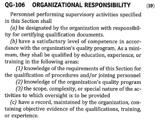

ASME Section IX now has a requirement that the individual charged with recording data while qualifying the WPS or qualifying the welder has to be technically competent and I believe there is recommendations as to what constitutes "technically competent (my words, not ASME. I'm traveling this week, so I can't quote the requirements, but I believe you will find it in Article I of Section IX.
Best regards - Al
Al,
That was added into the 2019 edition in QG-106, and revised slightly in 2021. I just received my 2023 version of the codes and QG-106 remains unchanged from 2021.
Essentially, it requires the organization to define the requirements of competence, qualifications, training, or experience. So, in the spirit of the subject of this thread, if an organization were to write the requirement of a CWI to witness and/or perform qualification tests (procedure or performance) into their Quality Program, then it would be required. Personally, I believe that's where this level of detail belongs.

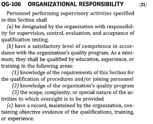

QG-106.1 and QG-106.4 was changed in 2023 edition.

Hello, i am new here. This is my first post. This is a 1.5 months old thread, so i wonder if someone will read what i have to offer. Here is my two cents on this: Section IX does not require a CWI to sign off on a WPS/PQR/WPQR. Anyone who is designated to do this in the organization's quality program can sign on these documents. It could be anyone, as long as he is designated for it.
Though,since 2019 edition - Sec IX requires people responsible for 'supervision and control' of the welding qualifications to be designated, and their competence be established through training records, experience, training, etc. So, OP probably needs such a person, who is conversant with Sec IX, to perform the function of supervision and control. But not for signing on PQR/WPQR alone. That can be done by anybody.
Another thing, if the testing is subcontracted (that is, lab is not part of the qualifying organization), then that lab can only furnish the results. Whether the results meet Sec IX requirements is for the qualifying organization to determine, not the lab. Also, the function of certification of PQR/WPQR must be done by the qualifying organization; the lab cannot do it. There is an interpretation, IX-07-13 (qs 1), which made it clear - that the work of certification cannot be sub contracted. QG-106 itself states this too, that the function of certification cannot be sub contracted.
