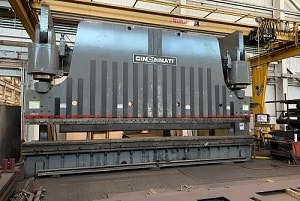

"What tonnage and model year of a second-hand Amada brake press would you recommend for someone looking to start a sheet metal business focused on brake press operations? Any specific factors or features to consider when making this decision?"
What is your target customer? Are you looking at HVAC type of bending or structural parts?
What materials do you want to form with?

"I want to create a custom sheet metal workshop based on customer demand, such as HVAC and construction. My materials range from aluminum to stainless steel and mild steel, with a press brake length of 3 meters."
You can't go wrong with a Cincinnati press brake -
but it is hard to make a recommendation without material thickness - tonnage calculator
I think I need 130_170 KN/m
I dont know if Amada brake press 2006 model year is capable for me or no.compare new one
