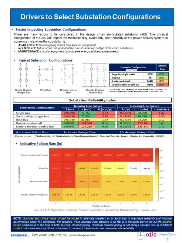

The majority of the power utility practices observed in the USA use ring-bus (RB) from 3 up to 6 positions for substations rated 69 kV to 230 kV. BAAH; typically is used for 6 or greater elements or if 4 or more transmission lines are considered.
The drivers behind this general rule of thumb are to meet conflicting parameters such as reliability, allowable planning outage - -maintainability, operation flexibility, NERC & ISO outage restrictions, economics, the importance of the substations, and other factors.
Below are some generic indicator data from different sources that may help support the decision to go from RB to BAAH configurations.
