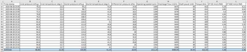

Here are some logs from tonight playing with rpms and pressure settings:
Unfortunately the system doesn't have a proper recycle line, hence it is a bit difficult to set the pressure to any desired value.

We have continued to measure the spectrum at different positions on and around the blower.
It is clear that all clear peaks are att 88,5 Hz (4 X RPM) which is the pocket passing frequency (rpm*4/60=1327.5*4/60=88,5 Hz). Meaning pressure pulsations.
The readings at 4 X RPM occur most clear on the seal house around the drive shaft.
Upstream and downstream the blower, 4 X RPM is not clearly identifiable which I take as that the silencers/pulsation dampeners are effectively eliminating pulsations created by the blower.
What to do? It seems like the blower is not rigid enough by itself to carry the load from its own pressure pulsations or how to explain it?
Can the pulsations create a pressure thrust motion in the unrestrained expansion joints that acts on the blower flanges?
