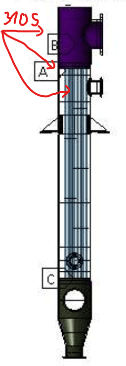

As you can see, in the photo is the design of this HE with the upper tube side, upper tube sheet and tubes are SS310S. The other parts are SS316.

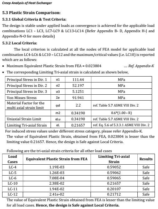

And this is the conclusion in their result. I can send you a full report if necessary.

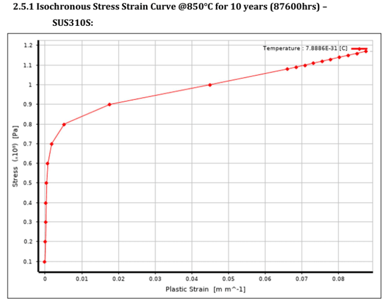

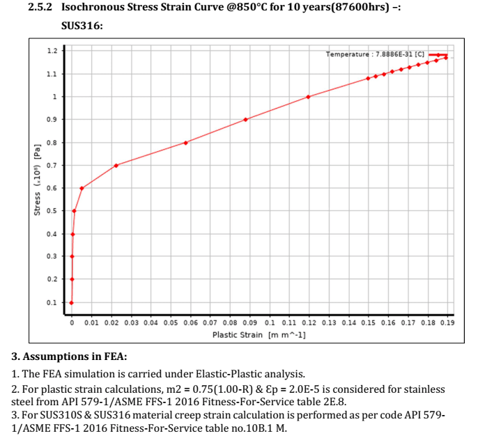

Currently, I knew that it must be time-dependent apply to yield stress and other characteristics of those materials in use. And the report is using 87600 hrs constant for 10 years to build the stress-strain curve as shown below.
I also did some extrapolation using some trending lines in excel but the results were not close to the table. The Y and U of 310S is smaller than 316 always. But I figure out that SS310S can handle higher temperature service than SS316. But so far, I cannot prove that base on stresses in ASME II D.

I calculated the isochronous curves for these materials for these temperatures and this time. I get absolutely nothing like the curves that you show.
Just as a note, the yield and ultimate strengths are a distraction at these temperatures - the behaviour is completely creep-governed. You really need to push back on whomever performed this work - it is extremely troublesome and potentially dangerous.

The isochronous curves are generated using the equations in API 579-1/ASME FFS-1 Annex 10.B. You should be able to generate them yourself using Excel or Mathcad (or equivalent). I would ignore any refence to "ANSYS" or other software. These curves are inputs to an analysis, not outputs - so don't allow yourself to be fooled thinking that they came from FEA software.
Thanks for your advice, I will draw the curve again following Annex 10.B, try to understand the method. Since I couldn't draw it by hand, the software helped me with this right after I typed the properties of the material in.

1. You have done an elastic-plastic analysis per 5.3 rules of Sec VIII -Div 2. This analysis do not take into consideration the creep strain rate. It's only a inelastic plasticity.
1. What is the maximum temperature limit in table 5.7 for 310S for the strain limit?
2. If you haven't considered the creep strain, obviously your Isochronous stress-strain curves can go wrong.
In summary, first and foremost, the material selection of tubeside 310S is wrong.
The table is limiting 480 C for stainless steel. It is the lowest temperature limit. It's not even reached the creep temperature of SA240 316. Could you please explain that? Thank you.
