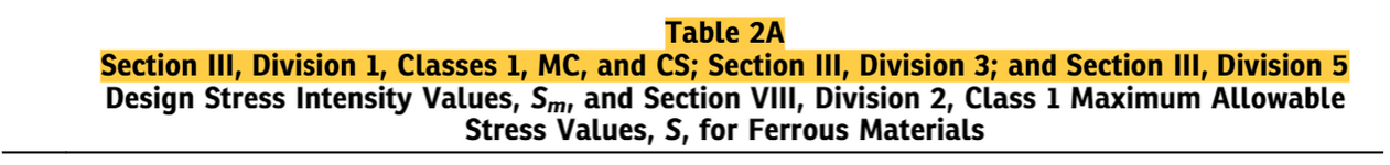

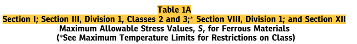

Refer ASME BPVC SEC II Part D, Subpart 1 Stress Tables , TABLE 1A (Max. Allowable Stress Values for ferrous materials) & Table 2A (Design Stress Intensities). I want to know the difference in results we obtained by using each of them and what is their actual difference from theoretical point of view.
Refer to Mandatory Appendix 1 and 2 of the same Section/Part for the derivation of the values.
All information appears in the header of these tables.
TABLE 1A:
TABLE 2A:
