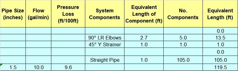

I calculated equivalent length as 119.5'.
Do I then add the 17' of lift to get a TDSH of 136.5'?

No don't add the elevation, just use the linear length to calculate frictional losses.
If you're using a pressured supply then you need to have a non return / check valve at the tank exit and flow at at least 1.5 m/ sec to blow all the air bubbles out. You will have water jetting out of the vent all over the floor or now need a drain point.
Better to fill from both ends and have an auto vent at the high point.
But unless you're going to build this and then never see it again, you will regret installing a syphon in the inlet to a pump for ever more....

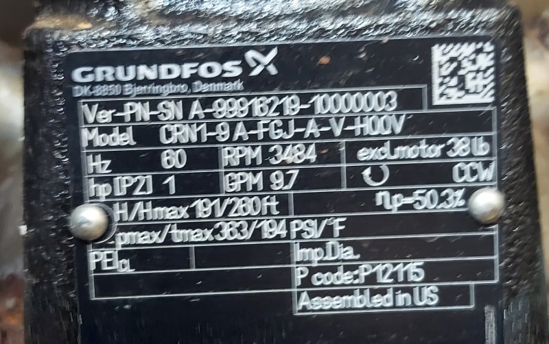

Ha. Made perfect sense as I was thinking and writing about it. Definitely more rambling rereading it. Let's start with a few picture.
Pump data plate

This is a used cart wash (Think mini car wash.) It's one of those someone decided to buy even though it is configured for a different layout then we have. I've been told to make it work.
It has a chemical soak, high pressure wash, and chemical sanitizer. Each with it's own pump and set of spray bars / nozzles. We don't care about the high pressure wash.
In the original installation the chemical tanks are located within 6' of the pump inlets, at the same height, and maintain at least a 3' level. In it's new home the chemical generator and chemical tanks are going to be mounted across the room. Requiring plumping between the tanks and the machine (chemical pumps) to go up and over.
The pumps in the machine aren't strong enough to push from the tanks to the machine / spray bars. Which means relocating them to the chemical skid from within the machine is a no go.
I wanted see if it was feasible to supply the spray pump from a pump at the chemical tank.
Tank > Pump > spray pump > spray bars
The spray pumps run for around 30 seconds at a time.
The fresh water only comes in at the end of the day. Valve A and B close. C Opens and the pumps run to rinse the chemicals off the interior for the night.
I only mentioned the fresh water spec as a high max pressure for the pumps inlet.
