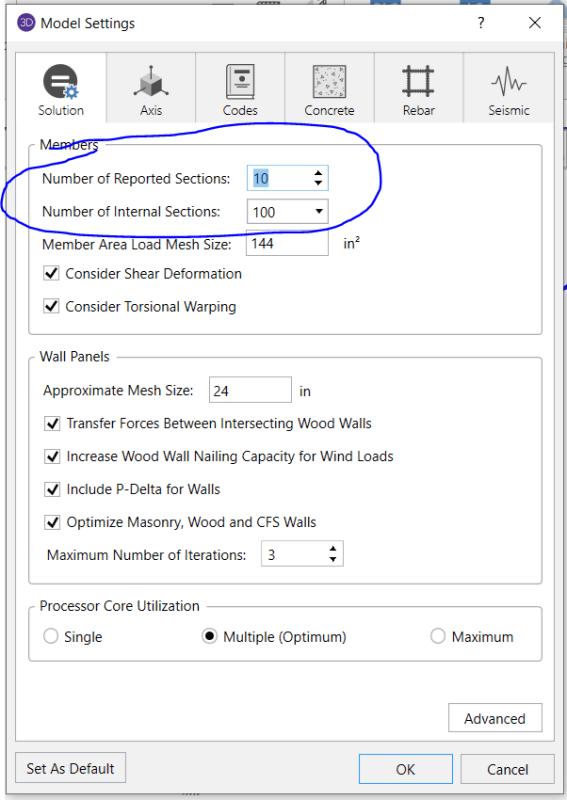

If you were to look at the Global Model Settings you would see that there are two settings on the Solution Tab for member sections. Number of Sections (for results spreadsheets) and Number of Internal Sections (for detail reports and code checks).

Yeah, I'm aware of those settings. It didn't make much difference, in fact, none at all:
With 10 sections, max dl deflection is -0.255 @ x = 278.55 in
With 20 sections, max dl deflection is -0.255 @ x = 278.179 in
I realize this isn't 100 sections, but I can't imagine there would be much of a difference since there is none going from 10 to 20 sections.
