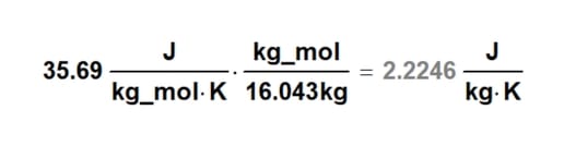

I found this interesting website
I followed their formula Cp = A + B*T + C*T^2 + D*T^3 + E*T^4 where Cp in kJ/kg-mol, T in K which resulted in that I get Cp for Methane at 20 deg C=35,9699614184067 kJ/kg-mol but for some reason it seems impossible to convert a value in kJ/kg-mol to kJ/kg K or Btu/lbm·R or Btu/lbmoF. Hence I can't even verify if the result is somewhat reasonable...
This shitty topic makes me feel like an infant... for example try to convert with any of these converters:
Gahhhhhhh [ponder]
Some days are like that.
From A kilogram-mole (kg-mol) is a derived metric SI (System International) unit of amount of substance. The kilogram-mole is that amount of substance that contains the same number of elementary entities as there are atoms in 12 kilograms of carbon 12.
It appears you need to divide by the molecular weight of Carbon (12) and multiply by the molecular weight of the substance to get the mass.
1 kg-mole =1000 moles >>>> for CH4 MW =16kg/kg-mol or 16 g/mol.
The quantity expressed in KJ/Kg-mol K should be divided by the molecular weight to get the right conversion in Kj/Kg K., not as written above.
If you need a professional unit convertor, visit Katmar software. Katmar is a member of this forum or Google Uconeer unit converter.

@pierreick you are my saver like always. 35,9699614184067/16,0426=2,24 kJ/kg K which match very well with the value in my reference table that is 2,22 kJ/kg K.
