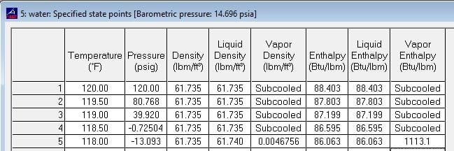

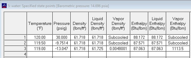

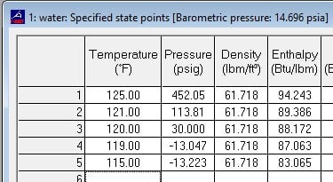

This has me a little stumped. Would it really go to sub-atmospheric pressures if it was hot at 30 psi and then cooled? Seems like it would just lose pressure but more than 30? Can anyone explain?
The density of water is so strongly dependent on temperature (vs pressure) that the starting pressure almost doesn't matter.
Using NIST REFPROP for pure water, keeping density constant when going from 120F at 30 psig to 119F, a mere one degree F of cooling, gives you a pressure of about -13 psig. Similarly, one degree of heating gives you ~114 psig, etc.
Comparing 30 psig to 120 psig, 3x the pressure, it takes another one degree or so to start boiling:
Yes it would, but that program prob ignores water compressive and pipe contraction.
