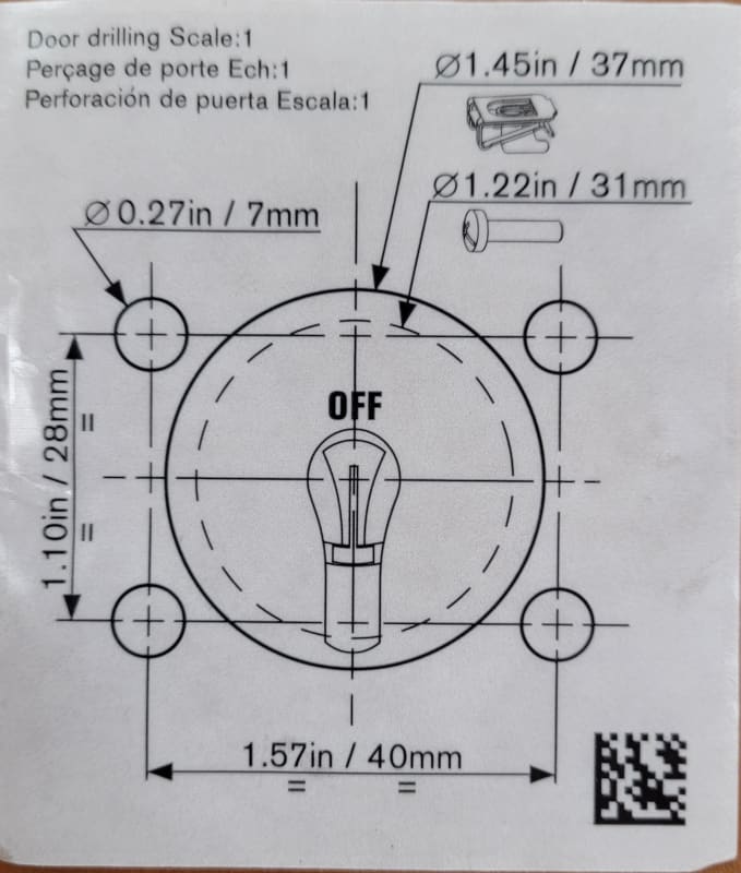

I am going to be using a control panel door mounted disconnect for which the handle looks like this ...
... This handle is constructed so that it will rotate 90 degrees clock-wise from the OFF position to the ON position. It seems this will allow me to mount this in a few different orientations. I am trying to decide which of the following would be a better choice:
(1) ON with the handle pointing to the left, OFF with the handle pointing down.
(2) OFF with the handle pointing to the right, ON with the handle pointing down
If anyone can tell me if either of these orientations is generally preferred, I would greatly appreciate it.

Thank you for your replies. It makes sense to me that it should be easier to turn the switch OFF than it is to turn it ON, and if gravity were to have an effect, gravity should turn it OFF rather than ON. This makes me think that mounting the switch so that down (6:00) is OFF makes the most sense. To Crowbar's point that the Manufacturer's instructions should explain the proper orientation, I have found these to be unclear. My disconnect is a Schneider Electric GS2GU3N. The accessories I have are a GS2AH140 rotary handle, a GS2AE2 shaft extension, and a GS2AEH12 guiding support. The rotary handle shipped with an adhesive backed label to assist with drilling the necessary holes in the panel door, which looks like this...
... The label makes me think that OFF should be in the 6:00 position, but page 2 of the following instruction bulletin seems to contradict this...
I emailed Schneider technical support to ask for some clarification. I will post here if / when I receive a reply. If the additional information I have provided makes anyone here think that OFF at 6:00 is a better choice than OFF at 3:00, or vice versa, I'd greatly appreciate anyone's opinion.
I looked at some old photos of a panel in which I used this same disconnect previously. For that panel, I picked out the disconnect, but I had a UL panel shop assemble and wire the panel. They mounted the disconnect so that down (6:00) was OFF and and left (9:00) was ON. They didn't ask me my preference and I never thought about it. It worked and I never had any complaints from my customer or from any inspectors. This time, I have to mount it myself, so I'm just hoping that I can explain my reasoning for whichever way I end up mounting it.

Thank you all for you input. It is very much appreciated. The case that handle pointing down (6:00) would be OFF and handle pointing left (9:00) would be ON seems logical to me. A switch like this wouldn't be affected by gravity, but if it were, gravity would pull the handle down. Also, if someone tripped and grabbed the handle to avoid falling, this would result in the handle being pulled down. In these situations, it seems like it would be safer in these events if power were turned OFF rather than ON.
With this being said, Schneider technical support got back to me and said that the correct orientation is for handle pointing right (3:00) to be OFF, and handle pointing down (6:00) to be ON. They offered no explanation regarding the reasoning for this, but I mounted it according to their recommendation and it works. I'm sure it would have worked just as well in the other orientation, but I figure it is best to follow manufacturer recommendations.
