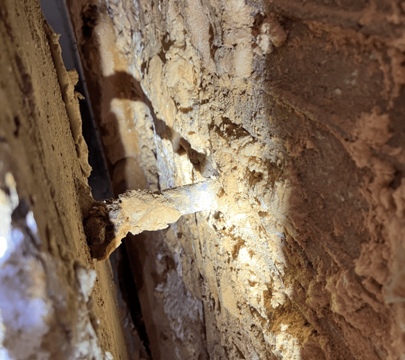

It's tough to show helpful pictures. The outside looks like a 7 story brick building with windows on some sides. The inside is flat slab concrete frame with bay spacings varying between 16' and 20'. The picture below is of the tie in an area where the cork and fart-rock had been removed and replaced by spray-in foam. The concrete column is on the left and the brick is on the right. I'm still trying to wrap my head around 7 stories of unreinforced two-wythe...
"Fart-rock" is a new term to me, but it fits. It is a foam glass insulation similar to blocks of pumice.
Well, if you're at 70ft tall and a wall unit weight of about 80psf, that's a 5.6k/ft load at the base. Each foot is going to be about 8*12=96in2. That's 58.33psi. That's a little over 1/10 of the mean unit compressive strength published in Table 1 of Brick Technical Note 3a for Molded, Solid Clay Brick. Mortar, even old lime mortar, still has a compressive strength well above 58psi.
Throw in those interesting ties (how have they not corroded away!?) for stability, and you're good to go, I guess.

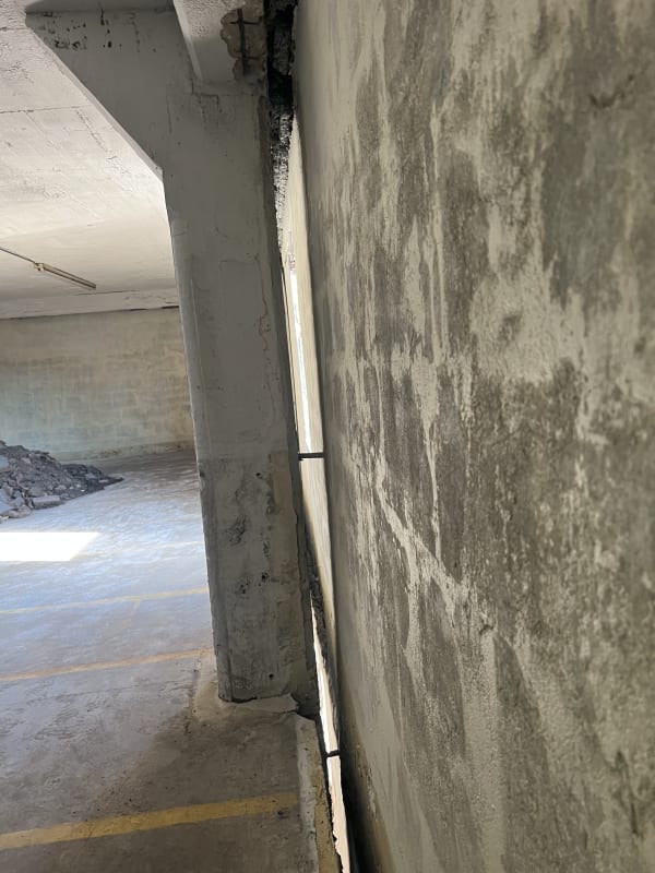

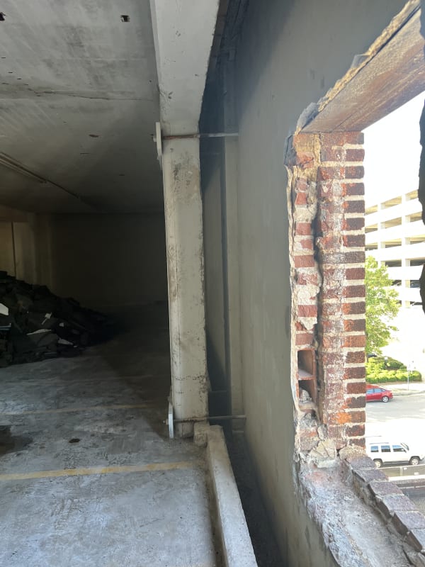

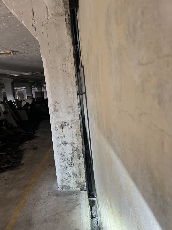

I appreciate your comments. Below are a few better pictures. It appears that the ties were not installed at all of the intended column locations, and heavy steel retrofits were used instead. The brick is finished on the interior at this particular floor. The pattern on the parge is where the foam glass insulation was placed (which may have been a later modification). There are three wythes of brick visible at the window, but only the outer two are joined. This might be some sort of cavity wall system. I thought it was most two-wythe based on some other openings, but the details vary throughout the building. We're still exploring. I can't imagine these are not attached to some sort of hidden steel grillage or lentil. Is anyone familiar with any internal masonry reinforcing systems being used in the teens?
