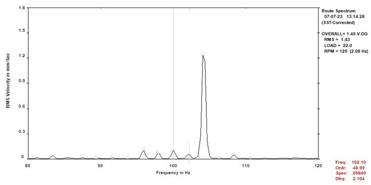

Hi.
I measured a bit strange stator vibrations at one hydro power unit. It is a 125 rpm vertical Francis turbine (~24 m head) directly connected to the generator. There were totally four accelerometers installed radially at the stator frame and all measurement locations indicated similar responses. Typically it is the 2X line frequency (100 Hz) that jumps up when the unit is excited. (Typically means another similar units, this was the first measurement at this specific unit so so not know the history) Now the highest component was ~104,2 Hz meaning 100 Hz + 2X rotational frequency (see attached spectra). The grid is very stable so the frequency is not 2xLF. Any ideas what causes this?
Br:
-Jari
 https://files.engineering.com/getfile.aspx?folder=15465779-7e93-4ad9-9232-8d953376726f&file=Stator_vib_104,2_Hz.jpg

Without seeing the chart, any chance it is 50 Hz electrical times 2.083 Hz mechanical rather than 2*50Hz electrical plus 2*2.083 Hz mechanical?
52.1 Hz prior to connecting to the grid is not uncommon.
It would be trimmed down a little before the breaker was closed.
If the unit is connected to the grid and showing that peak at 104.2 check the calibration of the equipment.
A quick test on equipment that is known to exhibit grid frequency vibration may be a quick way to verify the calibration.
It is hard to understand what may cause a vibration so close to the grid frequency, but not at the grid frequency.

tried now with the camera image. If it will not open, the picture just presents measured vibration response spectra having following rms- amplitudes: ~0,1 mm/s @95,84 Hz - ~0,1 mm/s @97,92 Hz - ~0,1 mm/s @100,0 Hz - 0,1 mm/s @102,8 Hz - ~1,25 mm/s @104,2 Hz. What comes to 104,2 Hz frequency there are of course lot of possibilities how it builds up. Just wanted to give a combination what matches the frequency. Actually your 50 times 2,08 Hz is more realistic and also 100 Hz with 2,08 Hz (rot. speed) sidebands are one potential theory. 100 Hz + 2*rot.freq was not a good example.

Do you have a vibration at 4.2Hz?
Salient poles?
Possibly the air gap of one pole off spec?
One coil reverse connected?

Rotor ground fault or turn-turn fault? Jumpered coil is equivalent to a turn-turn fault. But it really would show up at the mechanical frequency.
Just curious, how many wicket gates and turbine blades? Could you possibly be seeing prime mover vibrations coupled to the stator?
Just a thought.
If you are using accelerometer vibration probes, they are not reliable at speeds below 600 RPM. Normally, you measure contact/non-contact shaft displacement probes to measure the shaft movements for such slow speed machines. And 1.2 mm/sec rms is low and is in smooth range.

- There is vibration at 4,2 Hz frequency. Amplitude is 0,13 mm/s, rms and measured at the stator core.
- Saliet poles = yes
- Air gap issue = fully possible. Probably the air gap is not measured for a loooong time (=meaning a few decades)
- Reverse connection of one coil -> will lift up this possibility with the discussions

- 24 wickets but do not know the number of turbine blades, have to check it. The phenomenon is clearly connected to the generator excitation.

Why not 100 Hz but 104,2 Hz?
It's called a beat frequency.The sum of 100 Hz and 4.2 Hz.
Puzzling to me is why we are not seeing the difference eg a similar peak at 95.8 Hz.
We do have a peak at 95.8 Hz but the amplitude is much lower than what I would expect.

I missed the fact that 4.2HZ is related to 2X rotational speed. I take it that this is a 48 pole generator?
Has a pole drop test or a flux test been performed to check for shorted turns on the rotor? As you know shorted turns on the rotor will create an unbalanced magnetic attraction that would cause vibration related to running speed that potentially would add to the 100HZ fundamental. Very similar to eccentricity in the air gap that was mentioned earlier.

Looking at the spectrum I would guess the overall pattern is 2*LF with multiple running speed sidebands. The fact that one sideband at 104.2hz happens to jump up higher than the others may simply be amplification by mechanical resonance at that particular frequency. If you can reproduce that frequency by bump testing various locations, that would tend to support the idea of resonant amplification. But if you can't reproduce it, that would not be as conclusive because recreating the spatial excitation pattern necessary to excite the unknown modeshape may not be a trivial excercize (especially in the case of relatively high resonant frequency on large structure where the structures act very flexible and modeshapes tend to be complicated... the opposite of simple rigid body motion)
The 2*LF with multiple running speed sidebands seems consistent with a rotating asymmmetry of some kind (as previously mentioned, possible shorted turn, possible rotating eccentricity). But if you confirm that one peak is resonantly amplified, it may not be as much a concern since the remainder of that pattern is quite low in magnitude.

My guess would still be resonance. There may be other explanations far beyond my understanding. I personally don't see the analogy between pole pass frequency sidebands around 1xLF in current on an induction motor and these 1x/2x turning frequency sidebands around 2LF vibration in a sync generator. But you never know...
Did you try just a bump test (nothing electrical going on)?
Looking around online I found a paper that ties stator vibration with 2*fe+-Fr for a rotor eccentricity (Fe is grid frequency, Fr is rotor frequency). Not quite the frequency you’re seeing but same idea. This paper references another one on the topic but I wasn’t able to open it.
At the next shutdown you might consider a pole drop test and an air gap measurement if you don’t have that data already.
