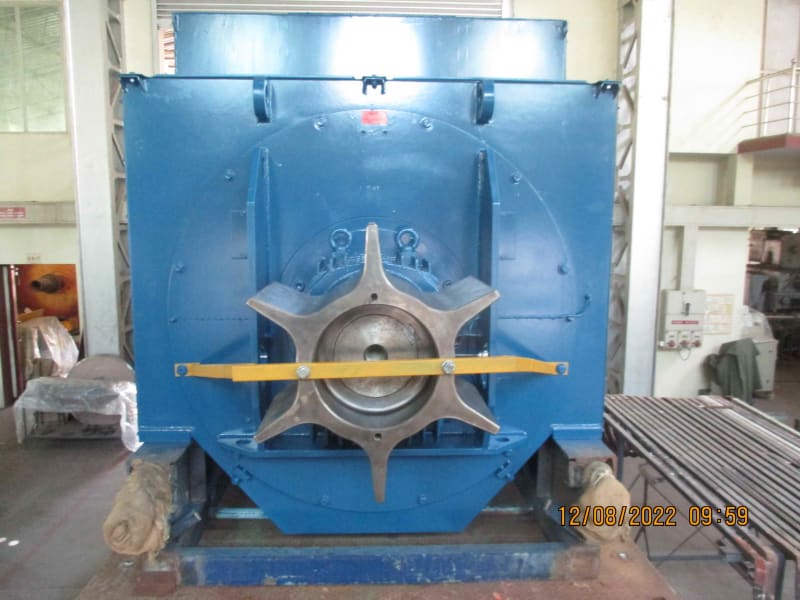

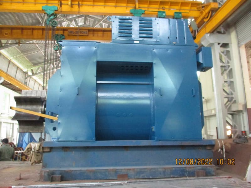

8 MW, 8 pole open ventilated generator rewound (6.6 KV to 11 KV conversion) in our shop.
30 tons / 12 ft x 8 ft x 9 ft (H) app.
A similar 8 MW, 12 pole machine will likely have 20% bigger size and would weigh probably 30% more.

Yes, it's a diesel. The client is an IPP and bought this used 6.6 KV generator which we rewound for 11 KV to match his other 11 KV DG sets. Running well for two years now.

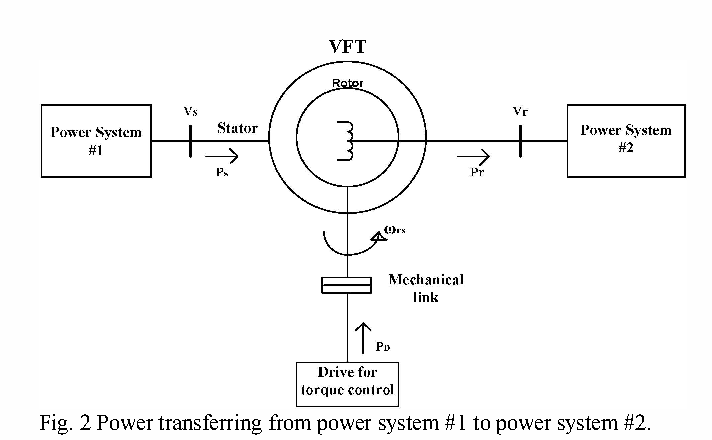

What Watoss is describing is (I think) called a Variable-frequency_transformer
[URL unfurl="true" said:
https://en.wikipedia.org/wiki/Variable-frequency_transformer[/URL]]General Electric installed a 3 × 100 MW VFT substation in Linden, New Jersey, in the United States in 2009. It connects the power systems of PJM & New York Independent System Operator (NYISO). This installation is in parallel with three existing phase-shifting transformers to regulate synchronous power flow.
Not many installed.
Power transferred is proportional to shaft torque.
Frequency change is proportional to shaft speed (and pole count).
The parts could be rearranged, to make this look like a wound rotor variable frequency motor setup used as a generator. The control scheme would be challenging, but the shaft speed need not be constant for constant frequency output.

The big one is located on a small island in the Saint Lawrence River, on the Canadian side of the border. It too has three units: each 600 MVA. Each has the rotor speed/position/power angle controlled by a DC motor rated 3500 hp at 0.1 rpm. Yep, one-tenth of a revolution per minute. The rotor never moves more than a few inches in either direction at its diameter. The units are connected to provide an "airgap" to isolate the power grids of New York State, Ontario, and Quebec - so there isn't a repeat of the catastrophic avalanching type of fault that occurred in the early 1990s that took out a large chunk of the northeastern power grid (in both countries).
As far as the basic difference between a synchronous machine and a doubly fed induction (also known as a Wound Rotor design) is that the synchronous rotor is fed by DC. The induction rotor is fed by AC, typically as a three-phase supply. Both stators are three-phase AC windings.
