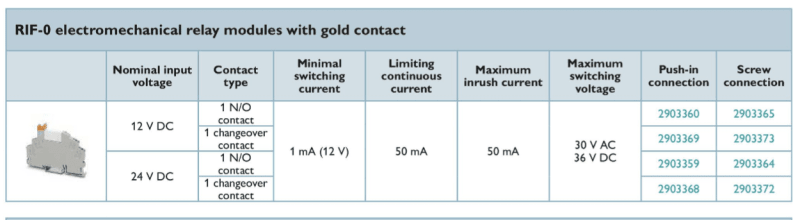

Use a sealed gold contact relay for low signal levels like that.
Energize the relay from the control when more rpm is required and use the NO contact to pass the 0-10V speed signal to the converter.
Put a resistor across the 0-10V input if necessary to ensure 0V when the relay is open.
Your mention of gold contacts has led me to some new knowledge. I did not know that relays had a "minimum switching current".

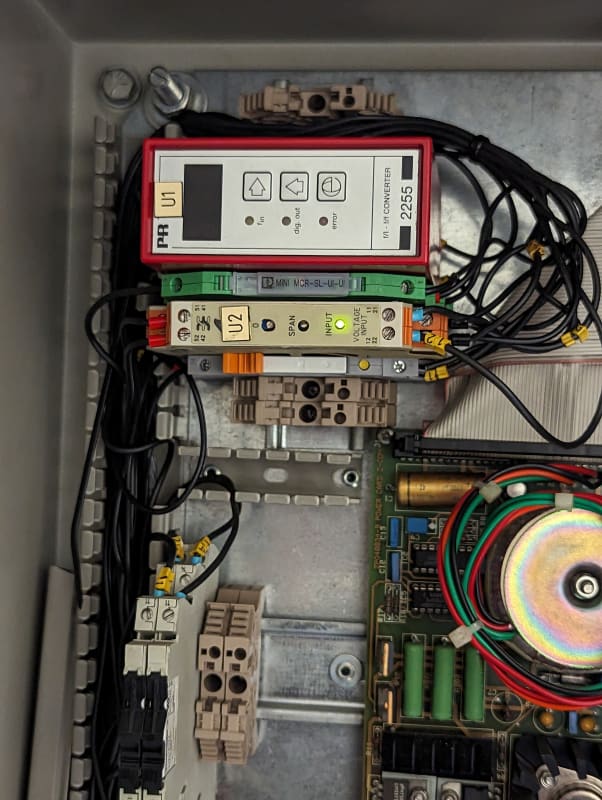

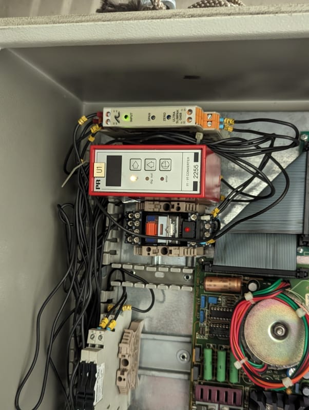

Thanks for the help, job is done. I added a second converter and replaced the relay with one that has gold plated contacts.
Before:
After:
