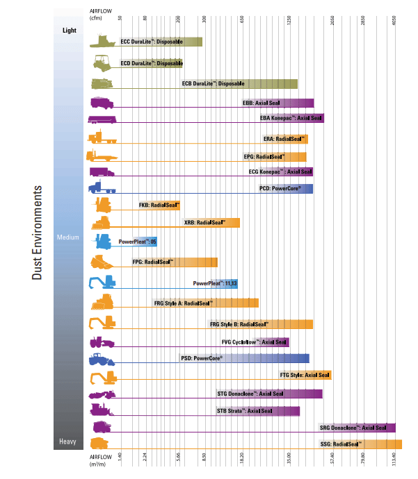

Update: I found this PDF document -on page 13 EBB filters (like P181099) are rated up to 1650CFM while P181038 is an SRG filter which is rated way above 2050CFM ...
Here is their chart; if you search the above doc for the two models you will find the type of filter for each (EBB and SRG)
So practically then both cover the CFM requirements but it all comes down to how heavy is the Dust environment (left side scale)
