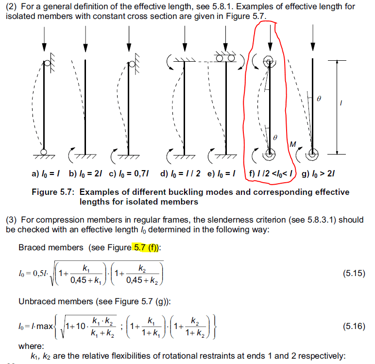

I'm trying to calculate the effective length of the column. The Eurocode 2 mentions the following equation
In that, we have to find out the "k" values so we can feed to the above equation.

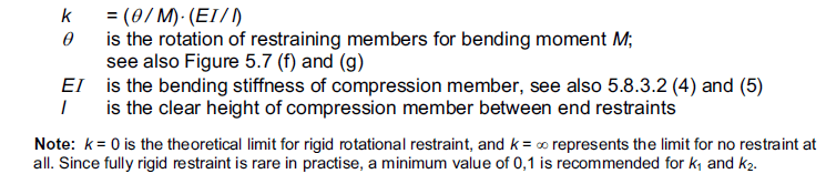

The Eurocode 2 mentions this equation to calculate the relative stiffness k.
I noticed the "Background paper to the National Annexes to BS EN 1992-1 PD 6687-1:2010" mentions all the beams connected to the column should be summed up and considered etc.
But I noticed the calculations in design books only consider the beams with lowest moment of inertia. And usually summing up only two weakest beams.
What is the correct way? (picture below)
1. Sum up all the four beams regardless they are different in stiffness?
2. Sum up the two weakest beams? (purple colour beams) (lowest moment of inertia)?
3. Sum up the beams ? (2 connected to the weakest column axis) (still the purple beams in this case)

Surely it's just l_o in the x-x axis, you sum the beam stiffnesses that provide restraint in that direction.
For l_0 in the y-y axis, you sum the other beams. All other things being equal, buckling will occur in the highest l_0.

If I take equation (5.15) and include the preceeding text we get a reference to Figure 5.7 (f). That is a column with rotational springs at both ends. So this is a 2D buckling problem and l0 is the buckling length for the specific column in a specified plane.

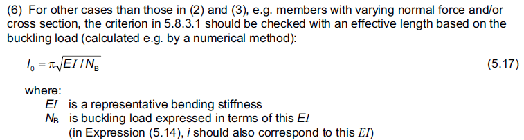

I have also included a paragraph that comes a bit furter down in the same chapter:
It defines l0 in a more general context. And if you rewrite that equation a bit you will hopefully recognize Euler buckling.

Thank you, now it makes sense.
