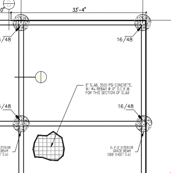

Here's the image that I screenshoted from the building drawing. I think it's the structural slab.
The geotech report recommend the foundation (caisson)'s column to bell diam ratio to be 3:1.
"The recommended bell to shaft ratio is 3:1
 In case of borehole sloughing, bell to shaft ratio required to be 2:1 ."
The report also mentioned that the Allowable Net Bearing Pressure, psf for the Drilled and
Underreamed Piers with Minimum 12 feet below existing grade equals 4500 psf.

If structured, your loads are too high for having caissons at column locations. Friction piles in the pattern shown will likely be better. The structured slab will be a lot thinner. Check with the EOR. You may need caissons at the column locations, or maybe longer friction piles. Friction piles are a lot less costly than caissons. If you can use friction piles at column locations, keep the same diameter and go longer... it's less costly to make them longer than to change augers. I normally reinforce friction piles with a single 15M (#5) and at the columns you may want to use 4 - 10M (#4) vert bars.
The bell size may be noted as a max of 3 times diameter. Some 'spreaders' do not do 3x and may only do 2-1/2 times...

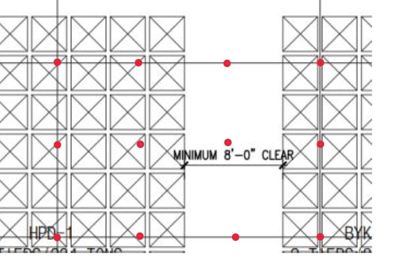

In reviewing the material, as a result of BART's comment, I missed a point... alternate loading may likely be a real issue if there is a possibility that the loading may be different in the future. With really high live loads this can be a problem. I usually use 2 span bottom reinforcing for continuity. I'll post a detail and you may want to use two span top reinforcing (it's like bottom, but covers top mats. I don't have a detail for that. I only have a detail for oneway with the 2 span reinforcing. For high staggered loads, the cut off points should be determined and those shown are likely inappropriate. The end span dowel should be extended to the end of the first interior mat).
Deleted Image
Modified a tad...
A variation in uniform live load of 100 to 500 psf is huge. Variable live loads are not shown on the drawings presented to date. The snip below seems to indicate typical reinforcement for the slab, which would suggest typical live load throughout. Belled pile sizes would suggest the same thing.
First, determine what the design live load should be for each area of the floor. Without that, we are just spinning our wheels.

Most of the floor (each 30' x 20' area) has a chemical tote live load of 40-48tons, maximum load (floor area) reaches 52 tons, in psf the range is (160psf - 200 psf) for chemical storages.
