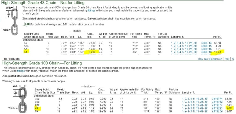

I'm looking for a full strength rated connecting link for 3/8" Grade 100 chain that will fit in the pockets of this chain wheel.

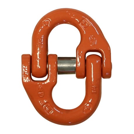

The Figure 8 connectors are too big for this application.

Same problem as previous requests - the only way to get the strength on Grade 100 chain is to have solid welded links. Alignment pins, bolt holes, screw holes, any holes of any kind to join pieces will drop the strength of the joining link too far unless the section of the link can be far larger than the base link. Which with that drum/wheel, it cannot be.
Were it possible the chain makers would sell them. Buy chain in 100 ft or 500 pound increments and buy links to make whatever length you wanted. That the chain makers don't do that is evidence they can't. That no one else that makes such links makes what you want suggests is isn't possible - this is not rocket science. Either fitting into that space or producing one that is affordable (Perhaps someone has a $1000 maraging steel link) is eliminating the item from the market.
Design a chain wheel that will work with available links or set up an operation for welding chain loops for your customers.

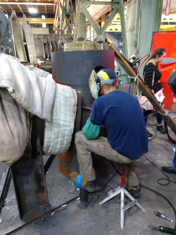

I have welders in house that I know would have no problem welding a link back together, but we also have equipment to follow a weld procedure.

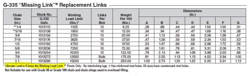

LittleInch, right idea, but the 2,700# WWL is way below the 8,800 of the chain.

In house we have many welders with unlimited thickness NAVSEA / AWS welding certificates.
This assembly is kept above 300deg for the next 3 months of welding after the root passes have been X-rayed.
Love the new induction heaters.
hendersdc, Yes, they are 100% rated, yet too big for the pocket wheel.

1. It seems that this is not an overhead lifting application
2. Have you made chain pull calcs - is this thing over-spec'ed
3. Can you upsize chain and reduce chain grade to reach an acceptable link strength
4. Can you get lower-rated links and load test
