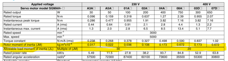

Since I'm working on a design of optical fiber rewinding machine (basically, the machine used to rewind the fiber from one reel to the other, maintaining the stable tension and winding pitch), I've made some kind of review of commercially available analogs. In one of the machines, that I’ve managed to become acquainted with, the reel is driven by direct drive (i.e. torque is transmitted in sequence servomotor -> disk coupling -> reel). The largest reel, compatible with this machine, as per datasheet, is 25 kg and 550 mm OD. Rated acceleration/deceleration time is 20 s (from angular speed 0 up to 127 s^-1), which makes the choice of the rated torque of the drive – 9,8 N-m – perfectly reasonable. But the thing the puzzles me so much is how is this drive supposed to cope with inertia of the load? The mass moment of inertia of the aforementioned reel is about 0,95 kg-m^2. Rotor inertia for this motor as per manufacturer datasheet is 0,0007 kg-m^2 and permissible load inertia factor is 5, i.e. maximum permissible load inertia is 0,0035 kg-m^2 – it’s incomparable with that of the reel.

I sincerely apologize for confusing you, looks like during the final check word processor slightly distorted the original text. I mean "motor sizing routine" i.e. the procedure used to determine suitable motor specs. I'll try to further clarify my question as briefly as it possible. There are manufacturer's recommendations for particular types of motors generally (and servomotors specifically) which limit permissible rotor inertia / load inertia ratio. In the application, which I described in previous post, this ratio is clearly not maintained by designer (I’m absolutely sure because I have disassembled the machine, I saw the nameplate of the servomotor, the assembly drawings of the machine and the datasheet for this servomotor). As far as I understand, if the mass moment of inertia of the load is significantly greater than that of the rotor, the load is prone to “drive” the motor when it is supposed to decelerate, and operating of this system could be unstable. Now the question is: this machine performance is proven by the long-term operation, so how do these facts stack up?

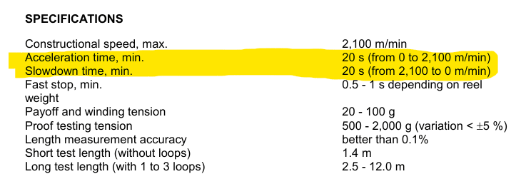

I'd be curious to see the full specification with that inertia limit. Did it also specify an acceleration time?

Which of them would you like to see? The load inertia limit is normally specified in datasheet for the motor, like this one:
And the acceleration time is specified in technical data list for the rewinding machine:

GetRobot.pro
See the rated angular acceleration in the specification? You can't get that acceleration rate unless the load is within the rated load inertia.
