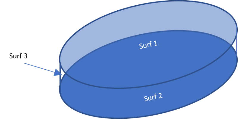

Hello ghylander.
Can you draw simple scheme in Paint to show where is third surface. I think that I understand your setup but it is better to clarify it.

This is a quick sketch:
You can visualize it as a CD, where the 3rd surface woul be the edge itself.

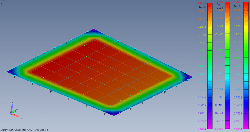

I did the tests you proposed, and I got some wild results.
I performed a total of 4 different tests:
1- Apply load on elements, each pressure on a different data surface, selecting face 1 or 2
2- Apply load on elements, using a data surface summing the pressures on each face
3- Apply a load on surface, swapping the magnitude direction for each face pressure
4- Apply load on surface, applying the summed pressures data surface
Only tests 2 and 4 yield the same results.
Test 1 does not yield the same results as any of tests 2, 3 or 4.
Test 2 yields the same results as test 4 but different to test 1 & 3
Test 3 does not yield the same results as any of tests 1, 2, or 4.
Test 4 yields the same results as test 2 but different to test 1 & 3.
Test 2 & 4 results are approximately 10x the magnitude of test 1.
Test 3 results are completely different from the rest.
Here are some results, 1 pic of contour on plate and 4 of scales for each test:

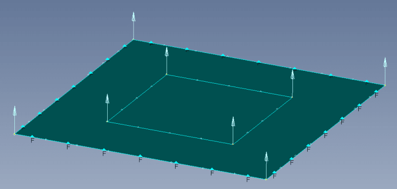

These tests and approaches assume each side of the surface is applied the pressure as a whole, while in reality what I have is:
So, on one side of the surface, the pressure is applied to it whole, while on the other side the pressure is applied only on the outer area.
Will test and report findings.

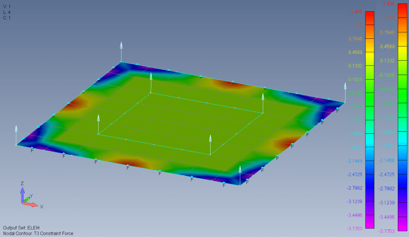

After runnin similar tests for the followig geometry:
The results are similar to the previous tests.
The drawback is that the pressures cannot be easily summed together.
Because of the interpolation, different mesh geometry between CFD and FEM, and different CFD mesh for each surface, you'd have to be very careful when summing the pressures into a single data surface.
It's simpler to just keep a separate data surface and apply it either on geometry or mesh.
Here are the constraint forces contour plot (summing nodal constraint forces match the expected reaction forces for the applied pressures)
