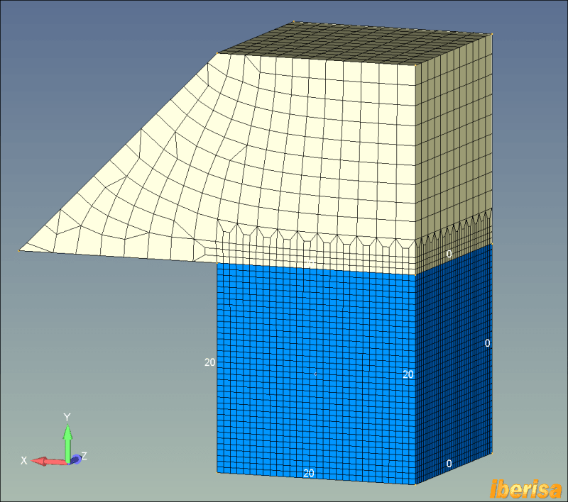

Hello all,
I have two different bodies which has to be meshed with different sizes (to reduce the comp cost). But I want to have same mesh on the surface that is shared between the two bodies. I could achieve this by mesh control on the edges, but since these bodies has complex shapes, solid meshing fails and only HexMesh Bodies works. Is there any way I could do it?
thanks for your time.
Dear Cathie,
BODY MESH is a new mesher technology we have in FEMAP to mesh complex solid geometry, take a look to it.
You can use the same element size in surface, but apply mesh transition to reduce model size.
I suggest to use the new FEMAP V2301 MP1 that give you the option to project midside nodes in geometry:

Thanks Blas for your reply. But I am more interested in HEX elements and unfortunately mesh BODIES doesnt have this option and thats the reason I use HEXBODIES which I find very effective. My project contains some 50 plates with some cavities and my point of interest are the few plates in the bottom and hence I would like to do fine meshing only for these plates. Hence I want to do coarse mesh in the top and gradually increase the no of elements as I go down. I cant use mesh control for HEXBODIES and my plates are neither symmetrical nor identical to each other. Is there any way to do it?
Dear Cathie,
I explained a similar problem in the SIEMENS FEMAP Commmunity: HEX transition.
We have in FEMAP V2301 the commmand MAPPED HEX REFINE, here you have an example:
I have prescribed a mesh size=50 in both the cube and in the touching surface of the other body, the rest of curves don't have any prescribed mesh sizing, the target is to use a global element size=100
The key: SELECT TWO BODIES AT ONCE!!
Using default options, only target element size=100, rest of options by default: the meshing command ignores the local mesh density prescribed to curves and use the global element size.
NEXT I can use MAPPED HEX REFINE command TO arrive to the following final HEX mesh:
