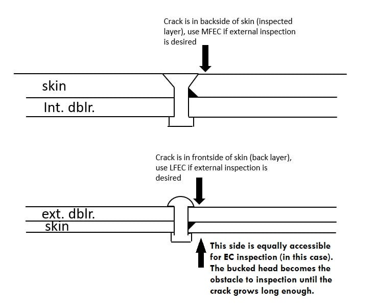

Hmmm... what fasteners are being installed and does the NTDM reference standard account for the fastener head overhang?
I see a lot of people get caught out by that... in analysis they assume detectable length is whatever the reference standard says, but usually for HFEC it is XX inches PAST the fastener head.
LFEC is is usually standardized from the SHANK.
Add on top of that, you need to be inspecting for cracks originating at the faying surface between the doubler and skin. So if your doubler is internal, you should be using external MFEC, which is not as sensitive as HFEC.
So if your options are:
1. Design with internal doubler and use external MFEC around fastener heads -or-
2. Design with external doubler and use external LFEC through the doubler
It is probably close to a wash in terms of inspectability tbh.
I see this all the time with DTA reports, people don't pay attention to the NDTM reference standards and set their detectable flaw size incorrectly.

Instead did you mean: an inspection internally using mfec, through the doubler, for a lead crack in the skin?
(Typ assume cracks are growing in the worst case location, in this case - always at the faying surface regardless of doubler on inside or out. Assuming also antenna not removed and doubler gage> skin)
Ng,
This is what I mean (excuse the hastily drawn figures):
My assumption is that we are always inspecting the skin, not the doubler, since this should be the critical detail for load transfer in the reinforcement.

Hi LiftDivergence!
You are quite right, the head must be accounted for, whether it is flush or protruding. And special-head rivets may be larger in diameter if lower in profile, thus delaying the detectability threshold. I believe the standard inspection tools on this aircraft for its external skin (per OEM insepction manual) is HFEC, which is unable to "see around corners".
I've taken the liberty to edit your diagram, since it's suitable to illustrate my external doubler considerations, too. My design concerns the lower skin, so in my application the diagram should also be upside-down. I didn't bother turning everything around!
