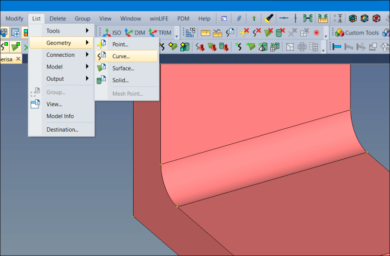

hey all, is there a specific feature on FEMAP to measure the fillet radius ?
do you mean to apply a fillet radius, like in a CAD program ?
I thought there was, probably under 3D shape tools
to measure on femap, not creating a fillet radius. i think I found a way to measure fillet of an imported parasolid. i find that there is no specific tool to measure but you can just create a point using a method "center" and then measure the radius of the point
Hello!,
You can use LIST > GEOMETRY > CURVE and select the curve of the fillet radius:
List Curves
1 Curve(s) Selected...
[pre][tt] ID Type Color Layer Bias MeshElem ------------------ Points ----------------- #Surface Length Radius Angle
_________________________________________________________________________________________________________________________________________________
25 Edge 0 1 0. 0 20 21 0 23.56194 15. 90.[/tt][/pre]

Hi Blas, Big fan of your FEMAP work. Sorry for the late reply . thank you this was really helpful
