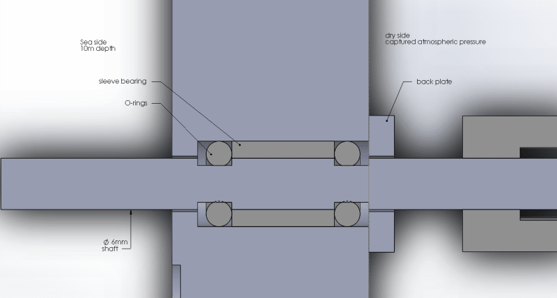

Here's a sketch for a dual O-ring seal and a sleeve bearing. Is this a sensible approach?
Is there a reason you insist on o-rings over lip seals?
I drew O-rings only because they seem to be easier for me to find. I'm not insisting on O-rings for fundamental technical reasons. Nor am I attached to O-rings emotionally.

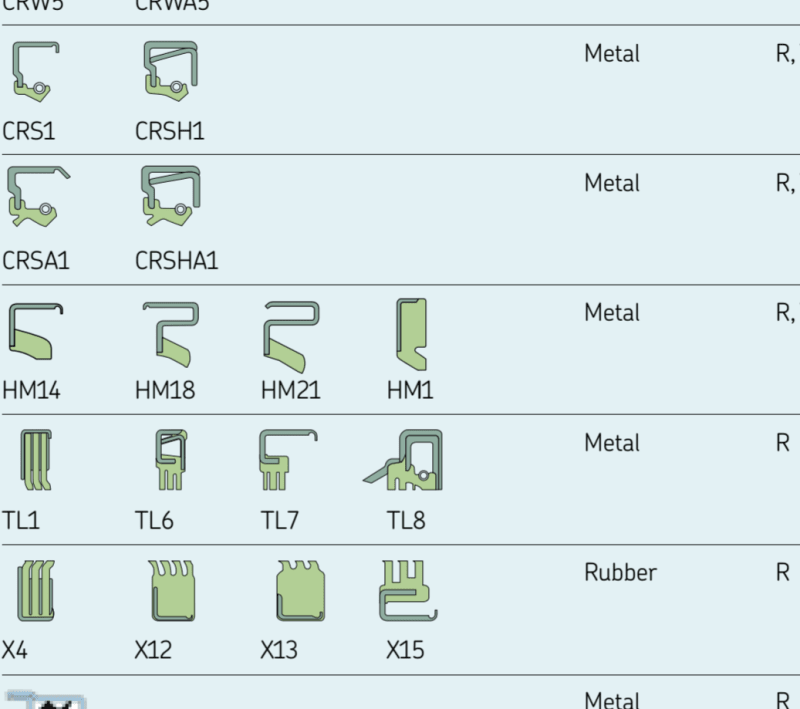

The Chicago Rawhide catalog is here but it doesn't have any profiles that I think would be appropriate.
You need a fully rubberized seal without garter spring, you don't want to be buying inconel springs.
The HM1 profile would be acceptable for your application if lipped for outwards pressure. They are available in 4.78 and 7.95mm shaft diameter... odd.

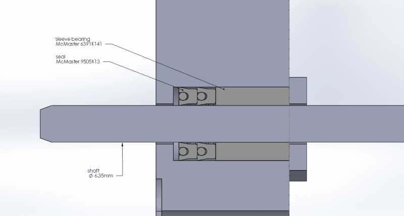

I haven't drawn-up a variant with the HM1 profile, yet. I was drawing a variant with a different kind of lip seal which I found on McMaster: seal, sleeve bearing.
What do you think?
I suspect that's 3/16 and 5/16 inch.
