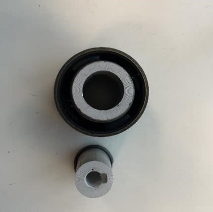

Hello,
We had a part fail in an odd way. The part is 6061 aluminum. The same company cast, Hot extrudes and machines. During our process a center core plug of the aluminum popped out. Being this was extruded from a billet, this is not supposed to happen. The company that makes the part has run a ground so to say, and does not understand how this happend.
Anyone have any expierene to this type of aluminum failure that can help?

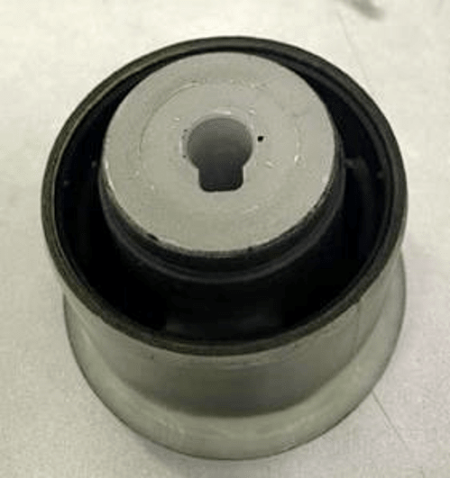

Thank you. Below are some picture of the failed part. The first image is what it is supposed to be. The second image is the plug out. The aluminum part is supposed to be one solid piece But as you see the core plug easily came out.

That is more uniform than I expected.
Have the alloy of the two parts checked.
Also, what does the die look like, particularly the support for the center hole and keyway?
Hardness is in spec for 6061. Hardness between both pieces match. Surface structure match. We tried to recreate with another part on our shear tester. Our molding machine maxes out at 9kn, the shear test was done at 90kn damaged our tooling and did not press out.
We are of the mind that this happened at the extruder. The extruder is baffled, never seeing this before.
Not sure if this started at the casting since of the billet since it is just melted aluminum.
Can you give a ballpark sense of how easily that plug actually came out?
Stick,
I can push it out with my fingers.
Are the billets worked before extrusion?
Have they changed extrusion dies?
Have they changed extrusion ratio? Temperature? speed?
these should all be well documented so that they can be reviewed.
In fact they should all have control limits and charts to go with them.
These are friendly questions, you are just trying to understand the process better.
And I hope that you have your hands on all of the pieces that came out of that extrusion, as this likely effects all of them to some extent.

Could you push it out with your fingers the first time it came out? That would make me consider if the plug was something that happened after extruding (like somebody machined the plug and pressed it in the outer piece for some reason). I've seen situations where two separate pieces of aluminum went into the extrusion press and came out "welded" together fairly solidly (the bond only came apart during machining or a tension test), so that makes me question if this actually happened in or before the press. However, I've also never worked with hollow extrusions and wasn't too heavily involved with the actual extrusion process, so I could be way off base there.

Even if the dies have not changed, they often manually adjust them in production in order to have uniform flow through the different openings. Here it appears that the extrusion weld (bonding after going through the die) failed. A common causes of this is different flow speeds. This is, if the failure happened at such a bond. But I couldn't understand how/where else such a disconnecting failure could appear.
Is there a possibility there was a problem with the billet before extruding?
It almost feels like they greatly slowed or even interrupted the extrusion and that allowed surface oxides to form preventing the fusion of the separate elements.
EdStainless, since this is cast billet, can it be that the butt weld could have got surface oxide < say from moisture from air line> and did not weld correctly?
Even with that said, i have reviewed their process documents and the butt weld is supposed to be removed and scrapped.
