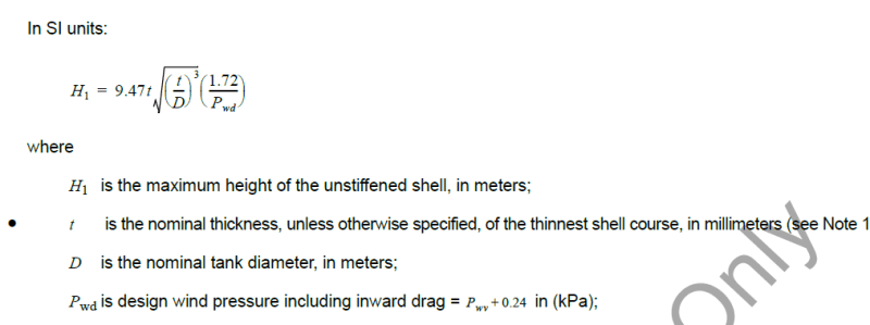

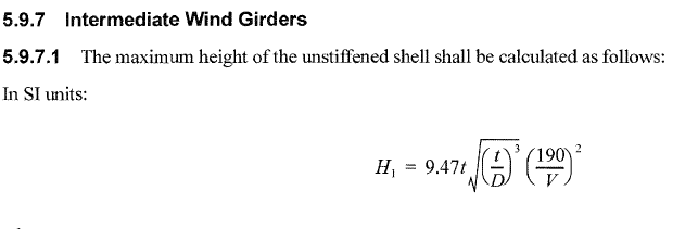

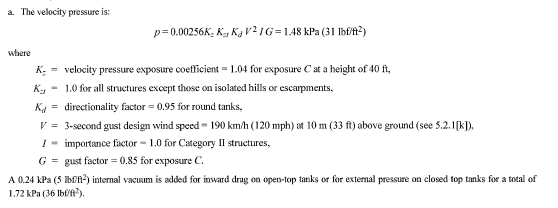

There was some confusion, as i was checking this in API650 12 edition, and there it was not mentioned clearly, regarding the addition of 0.25kpa external pressure in maximum unstiffened shell height formula.
0.25Kpa pressure addition was mentioned in velocity pressure formula, but velocity pressure is not being used in maximum unstiffened shell height formula.
so as per 12th edition i am still confused, but in 13th edition, it is explained clearly
So now i can safely ignore any annex-V calculation upto 0.25kpa
