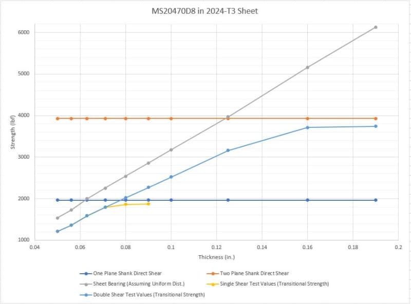

Maybe I'm missing something in this thread, but you wouldn't use the MMPDS values as the joint allowable. At least I wouldn't think to.
It can easily be checked, the shear strength values listed in a table such as 8.1.2(a) are literally just the based on the listed Fsu and the cross sectional area of the shank.
That would only act as the allowable joint load in the case that the joint was shear-critical, no?
In reality, most joints experience a transitional failure somewhere between bearing of the layers and shear deformation of the fastener. At least if the joint is properly designed.
We don't want to have shear critical fasteners per design. Joint strength should be based on transition failure data.
This is a plot I made for another post:
You can see, the shank direct shear values are the upper limits of joint strength. Your actual value would be lower than that. So yeah, MMPDS can give you the theoretical upper limit of strength, if the joint is shear critical. But that's about it.
Basically, I would not recommend using direct shear allowables from the fastener spec or MMPDS to determine joint strength in a structural substantiation.

really ... don't use MMPDS section 8 for fastener/joint strength ??
yes, table 8.1.2b is the upper limit.
plain shanks are adjusted by factors in table 8.1.2.1b.
CSK fasteners from tables with the specific fastener, like table 8.1.2.2f for BB (426AD) rivets.
which is a PITA for 1097 rivets (since they only have E material, table 8.1.2.2n)
shear critical fasteners ? why not ?? sure, some places have a preference (or a design rule) for bearing critical which pushes the design to either large diameters or small thickness ... but this is preference, not a "golden rule".
Yes, LD is correct. Many riveted and bolted joints do not reach fastener shear strengths. MMPDS/Mil-5 used to publish "joint strength" allowables which covered specific combinations of sheet materials and thicknesses and fastener types/diameters/etc, with the values given in terms of load/fastener and represented the most critical failure modes. Not sure if that data is in the latest versions.
are we all saying that using Fsu is not directly applicable.
