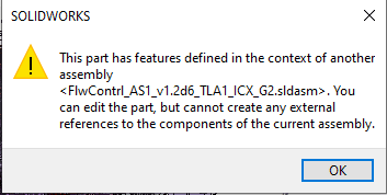

I'm working on an assembly in which some of the parts are virtual and had been created using in-context modeling method.
For the sake of the argument, I'm working on a version 2.0 of the assembly, while one of the virtual parts was made in the context of version 1.5 of the same assembly.
Now when I try to change a feature in the said virtual part, I get an error saying that the part has features defined in the context of another assembly (version 1.5), and that I can edit the part but can't create any new external references to the current assembly (version 2.0).
I scoured the internet for a possible solution, but everything I found had a PDM involved in it or it had nothing to do with in-context modeling (e.g. broken reference between a model and it's drawing which is easy to fix).
Is there a way to fix this F'ing issue, without having to rebuild the whole assembly again from version 1.5 to get to the feature needed to be changed?
Thanks!

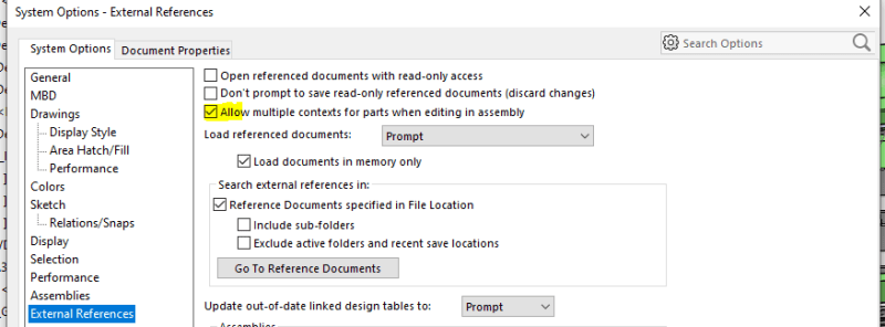

Tools > Options > External References and select "Allow multiple contexts for parts when editing in assembly"
Deepak Gupta
SOLIDWORKS Champion and Expert
SW 2022 SP0.0, 2021 SP5.1 and 2020 SP5.0
Boxer's SOLIDWORKS Blog
Thanks for the tip, but this didnt do a thing, still getting the the same error.
Checked the option you've suggested.
Tried to assigned a new reference.
Still getting the same error.

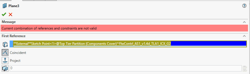

Try toggling the plane creation method and then change back to coincident. And then select the desired entity.
Deepak Gupta
Nope, didn't help either.

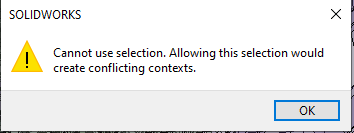

It turns out that I can't create any new feature (sketch, Plane etc.) using entities that were created at the 1.2d6 version of the assembly.
I'm getting an error
Is there a menu where I can pinpoint where/what is the conflict and is is fixable at all (without PDM)?

Fortunately I think the issue has been solved, though It's a little bit convoluted without a PDM.
I used the Solidworks-File-Utilities (replacement for the Soldiworks-Explorer since 2020) to rename the sub-assembly (".._v1.4d_..") with the out-of-context virtual part, to the last file name where the assembly still had all the external references in place (the name that pops-up in the error; ".._v1.2d6_..").
I copy-pasted the problematic sub-assembly (so not to mess up the original v1.4d sub-assembly file) to another folder --> renamed the assembly from v1.4d to v1.2d6 --> opened the top assembly and using the "Replace Components" in Solidworks I've replaced the out-of-context assembly with the newly renamed one (which already fixed the out-of-context issue) --> closed everything in Solid and renamed the sub-assembly again (using the Solidworks-File-Utilities) back, from v1.2d6 to the proper version name --> Then I've cut-pasted the renamed sub-assembly back to the original folder --> opend soldiworks and loaded the top-tier assembly again to fix the missing file issue (due to moving the fixed sub-assembly file between folders).
Hope this will help someone in a similar situation.
Now everything checks out, no out-of-context issues.
But it still annoys me, even infuriates, as this whole BS could have been done by some simple interface that just "tells" solidworks that "this is the new file name for the same reference", which is basically exactly what I have done.
I guess this is another one of those F'ing greedy marketing strategies of Dassault for designers to buy the PDM (like placing one of the most rudimentary features, namely the "surface flatten" behind a pay-wall).
