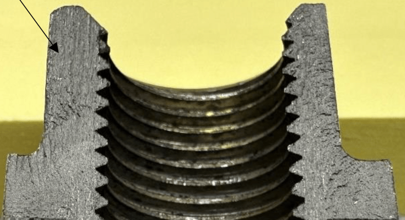

got pictures of the failed nuts?
Any kool failure analysis pictures from the accredited Metallurgical/Materials testing facility ?

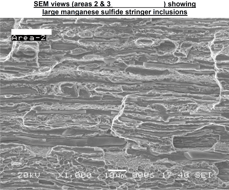

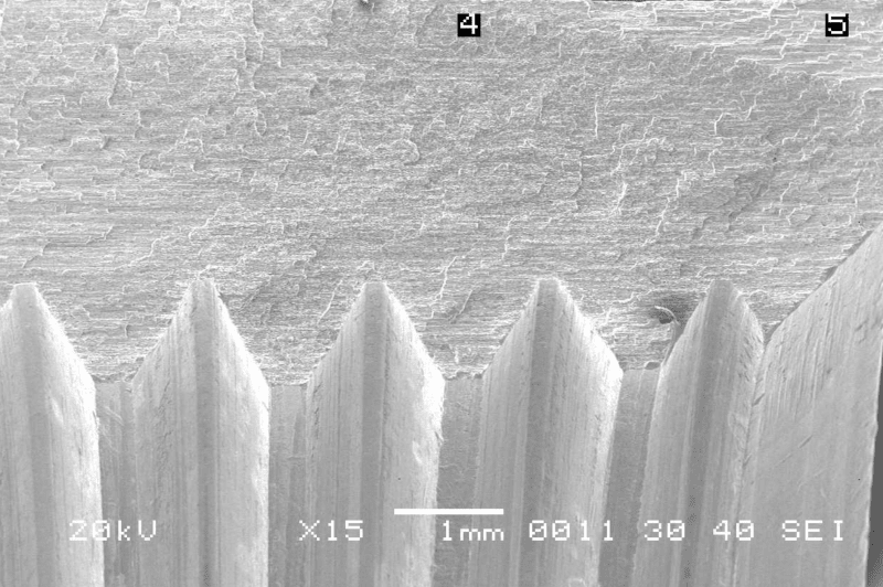

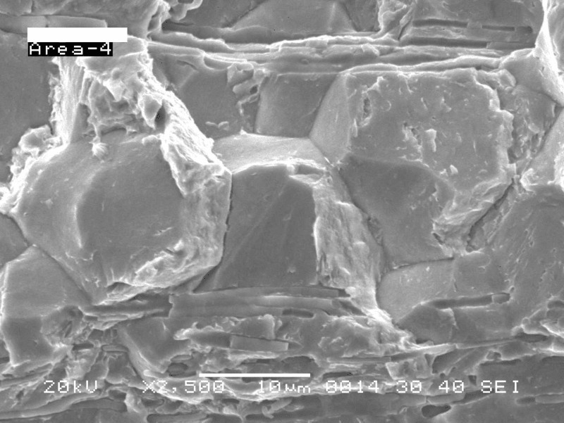

As for pictures, not much else detail for obvious reasons, but here you go:
Note that analysis for hydrogen content is not really useful because the hydrogen that caused HE will have dissipated through the matrix by the time the component is analyzed.
Do the pictures show a fracture surface?
Tmoose, yes those are all pictures of the fracture surface.

So the nut bodies just suddenly split in half vertically ( assuming the screw axis is vertical ) during 2nd to 5th tightening cycles ?
Or does one side open up, and the nut spreads open a bit?
Did you say how close to yield the tightening is estimated to be?
Are all the tightening cycles the same, or does the torque increase at each cycle?
Are the nut faces making decent contact with the face of the bolted component ? Or is the bolt or the component angled, like the flange on an I-beam?
