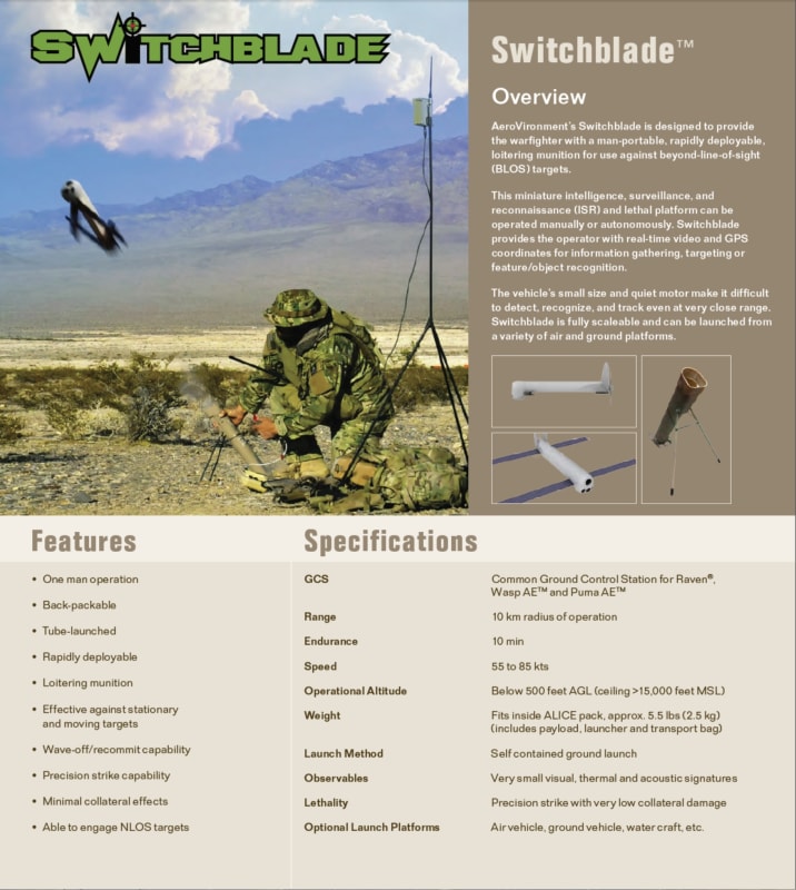

I am looking for cutaway diagram for small tube launched drones/munitions like Switchblade 300 (could be a drone of any class)...basically want to get an idea of internal structures arrangement for drones which have folded wing mechanism. Any open source papers or thesis recommendations are also OK.
Any pointers would be appreciated.
The datasheet shows you pretty much how it's arranged

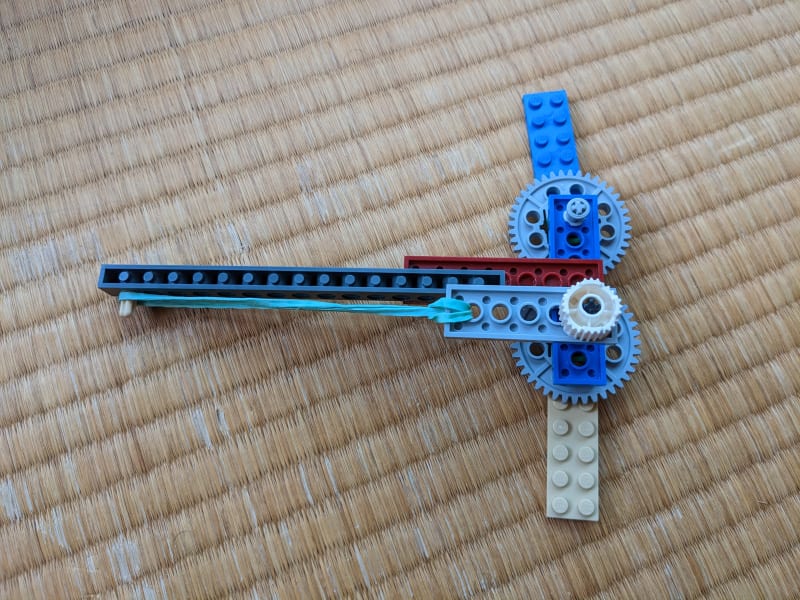

Pivoting wings aren't new. It's a wing with a pivot. I saw the first model with pivot wings in the form of a model rocket remote control boost glider - around 1975.
As far as internal structure - I doubt it has very much of one. Aside from the wings and motor every thing else could be a slip-fit inside the tube, if circuit boards and batteries aren't bonded as part of the structure.
