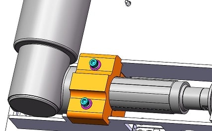

We have an actuator clamp top and bottom (SS) designed that holds a linear actuator in place and I need help with determining/calculating torque specification (in-lb) on the two screws that secure this assembly.
I have attached an image here of the assembly.
Bolt specification:
10-32 UNF 2A, SHCS
L= 2 3/8"
Material= 18-8 SS
(No special coating)
This linear actuator would be exposed to ~850 lbf and I want to ensure the screws secure the clamps adequately. Please help with determining what torque spec should be specified here.
If additional information is needed please message here. Thank you.

Here is the pic based on fix that 3DDave indicates to use -
There's an awful lot of guessing required about what the load path might be.
It looks like the intent is to clamp the barrel of the actuator and simultaneously clamp to the rails - you can't serve two masters, simultaneous clamping of the barrel and rails would require extremely unreasonable tolerancing of the components.
I have to agree with dvd, there’s no reliable way to clamp both the actuator and rails simultaneously.
If we are looking at this incorrectly then please provide more information.
Thank you for looking into this. Apologies for the image name.
The design intent is to clamp the linear actuator barrel to the base plate, not the C-channel. There is clearance between the top clamp and the C-channel slot that accommodates it.

Hi MEngg111
There are several ways to achieve the answer you are looking for but it depends how accurate you want to be, for instance specifying a torque can be has much as 25% plus or more above and below your target figure, bolt elongation is around 2-3% above and below the required force.
My opinion is that for this application then specifying a torque is probably good enough.
I would use this site and the formula under the sub heading of INITIAL BOLT TENSION
You probably need to guess at the load path as MintJulep suggested.
Then, make a free-body diagram of the clamp piece, and work out how much screw force you need to keep things in place.
I often use this screw torque-tension chart:
The notes at the bottom of the chart explain how the numbers were generated.
