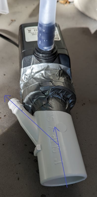

I recently bought this Y splitter:
Dawn Industries PVC Funny Pipe Wye (1" x 1" x 1/2")(SY010)s
I attached the input side of a pump to one of the big ends of the splitter, and then turned on the pump. I assumed some water would shoot out the little side path. That was the goal anyway - to split off some of the input water to the pump down the side path. But no water came out the side path. Can anyone help me understand why. And is there anything I can do to get some of the input water to go through the little side path?
This is the pump:
PULACO 400GPH Submersible Water Pump with 5 ft Tubing, 25W durable fountain water pump for Pond Fountain, Aquariums Fish Tank, Statuary, Hydroponics
I hot-glued the splitter to the front of it, by the intake. The rest of the pump worked fine when I turned it on, just nothing came out the side path.

The wye is about 30% offset relative to the flow direction. I just glued the big side of that splitter piece to the front end of the pump, so the setup isn't all that complex. The pump pulls the water through the main body of the splitter, given the suction, so I hoped maybe some of the water would also "peel off" and flow through the Wye. The splitter is on the inlet/frontend rather than the backend because in the real commercial application I won't have access to the backend of the pump.
Whatever pressure is pushing water into the suction side of the pump will be pushing it into the wye.

If the wye is on the input side, the body of the wye will be under negative pressure and watter will tend to go into the branch instead of out of it.
If the wye is connected to the discharge of the pump, you may not have enough back pressure.
Try installing a 1" x 3/4" reducing bushing into the outlet of the wye.
If that is not enough, add a 3/" x 1/2" reducing bushing into that.
Still not enough side flow?
Install a plug and drill a 1/4" hole in it. Increase the size of the hole in steps until you get the side flow that you desire.

Thanks everyone. Let me see if I can draw up a picture to post tomorrow. It sounds like the problem is that, because the splitter is on the input side, the wye is sucking water in (along with the rest of the splitter), rather than pushing it out. Which would make sense.
I've now made a picture, see below.
I was hoping that the fluid would flow as shown by the blue arrows, with at least part of the main flow into the pump breaking off and going through the Wye. But that doesn't seem to be happening.
Raise the pump with something and turn the Wye down. If the suction is flooded and there is enough head, and resistance in eye is small, there will be flow out the wye.

Flow is from region of high to lower pressure. Flow on y-branch will be into pipe.
Is there a way for me to create lower pressure at the y-pipe to siphon off some of the flow? I'd like the water to flow into a secondary reservoir.
I was hoping that the fluid would flow as shown by the blue arrows, with at least part of the main flow into the pump breaking off and going through the Wye. But that doesn't seem to be happening/
That's not the way inlets work; your pump is sucking water in, so regardless of which direction you place the wye, it will be an inlet and not an outlet. You are better off diverting flow from the the outlet of the pump
