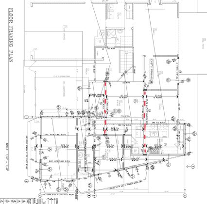

I need help and ADVICE with this structural drawings. Is it possible to have two 10” deep Beams on the First Floor Framing instead of the two 12” deep Beams on the Drawing? This will allow us have a Flush Ceiling with the Existing. Attached is an LINK to the Existing and Proposed Architectural and Structural Drawings. I couldn’t upload the pictures here.
Can you show a single plan with the beams shown in 'red' or something of that ilk? If the beams are steel, it is likely possible by increasing the beam weight to accommodate added deflection. Pick a smaller one with a larger section modulus and a larger Ix value... should work (subject to vibration issues). Something similar with wood...
I just attached a single plan with red dotted line showing the two beams to this thread and I also added it to the album on the link that I shared. The shorter Beams is a PSL and the longer one is a Glulam.

If this is for a school project, you should match or exceed the Sx and Ix, using wider beams. If this is an actual structure to be built, discuss the options with your structural engineer.
You will need to go to a stronger grade of PSL and wider. Stability should not be an issue if wider and the strength increase is linear. Equivalent section modulus = New Grade Strength / Old Grade Strength * Old section modulus. For deflection moment of inertia = b * d^3 / 12 for new member should be greater than the old one. Going from a 12" to a 10" beam, the increased width will be in the order of (12/10)^3 = 1.7 times the old width.
The second beam span appears to be quite large, and there may be problems with a direct substitution, with vibration.

I have told the designer to change the Beam depth to 10" and he said it can't be done. But am thinking there could be other options. That is why I brought it here for all to see and advise. Thanks!

If you know the I you need, and the depth is fixed at 10", then change the section ...
the thickness,
the width of the cap flange,
the grade of steel ?
or reinforce the beam with straps.
