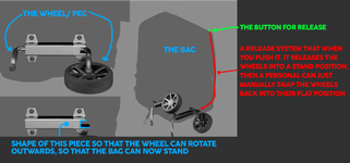

We’re working on a project and need help designing a foldable wheel mechanism. The idea is to have the wheels at the bottom of the trolley clip securely into two positions:
Flat Position – The wheels are tucked under the trolley, allowing it to lie flat.
Extended Position – The wheels are rotated outward to allow the trolley to stand upright.
We want a mechanism that allows the wheels to clip into place in both positions. To release the wheels, we envision a button-based mechanism that disengages the lock, allowing the user to manually rotate the wheels to their desired position. However, the mechanism should not automatically lock the wheels back into place when rotating – the user should manually clip them into position after releasing the lock.
Our current design includes a flat metal bar that holds the main pipe where the peg and wheel are attached. However, we’re struggling to visualize how the release button and locking mechanism should work together to achieve this functionality.
If anyone has ideas, diagrams, or references to similar mechanisms, we’d greatly appreciate your input!

I don't think the button release mechanism adds anything to the functionality and adds a lot of complications.
even if you do find something to work, the bag will still need to be laid on its back or side whilst someone folds the wheel underneath so what good is the release cable? Makes no sense to me. The mechanism looks good so far, you just need to provide enough friction or a clip to hold the wheels in the down position, but how do they stay folded under?
only other option is to insert a spring somewhere which holds the wheels up and then your mechanism can be a simple ratchet that holds the wheels in position when you lift one side and use your foot to push it into position?
"the user should manually clip them into position after releasing the lock." I think this messes up the idea. Initially the wheels had two positions ... retracted and extended ... simple. Maybe this is "just English" ? I agree that to have someone move the wheels into their extended position is "clumsy". A simple spring (or many other ways) would deploy the wheels after they are released, but you can do that mechanical work manually ... but remember two positions only ... fully deployed, and fully retracted. Like I said maybe just who I read your words !?
But then if you are going to manually move the wheels from one position to the other, why a "button" ? lay the bay down, so the wheels are off the floor; have the wheels (each one) secured in their retracted position by a pin into the structure of the bag, undo each pin (in turn), move the wheel to its extended position, and secure (each wheel) with the same pin into another part of the structure, or have a second location on the wheel (a second flange at 90 degrees ?), to secure (each wheel) in its extended position.

All you need is a spring to push the wheel/leg to one end of its travel, and a notch for each position.

Consider mechanisms that are used to hold folding table legs in the down-position and provide resistance to side loads.
One can employ either a push-wire or a pull cable to actuate the release mechanism. With few expected uses and a judicious routing even solid wire can last longer than the bag. Routing is more flexible with a twisted cable in a housing, such as used in many bicycle mechanism.
Also be aware that making it able to release when being pulled by the handle might not be popular with the user, so find a lever or button arrangement that is not part of the user's grip on the handle or require the user to push the release button in some other direction before pulling.
