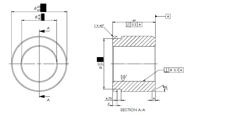

I haven't used Geometric tolerances for a while, so I just wanted to double check I'm not going insane
I stumbled across a drawing (see attached / or below post), and I'm pretty sure the geometric tolerancing is wrong.
1) The parallelism looks to be on a wrong face?
2) Also, personally I would have thought it would have been better to datum A the external of cylinder and put a concentricity on the internal, rather than a perpendicular?
 https://files.engineering.com/getfile.aspx?folder=770750d5-dbfd-477a-9306-377e342958fc&file=tolerances.jpg

That being said, I see no problem with where the 'A' datum has been established nor the use of the parallelism constraint. True, it would seem that there is a missing concentricity constraint, perhaps even two, as the bottom of the groove needs to be constrained as well, plus the walls should be parallel to the 'A' datum as well, but then we have to assume that there are default tolerances, in which case, the only tolerances needed on the drawing are those which are either more or less precise than what the defaults standards would indicate.
