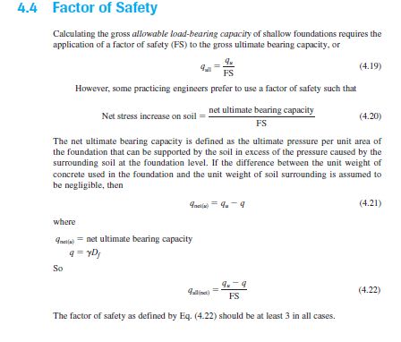

It is hard to comment without knowing that the Consultant A allowable bearing capacity (Qall) of 5000 psf is if Gross or Net bearing capacity..
The following is excerpt for the bearing capacity FS. (from Principles of Foundation Engineering by BRAJA DAS )
My suggestion would be try to see the bearing capacity is gross or net and adjust it .

The Terzaghi general bearing capacity (with Meyerhoff factors, but this is irrelevant) method give us ultimate bearing capacity (qu). To get allowable you divide it by a SF usually 3.
Nowhere in the Terzaghi method does it say to add the overburden stress on to make it gross. Consultant B is wrong IMO.
Regarding settlement calculations Consultant B is correct in only using the qallowable net.
